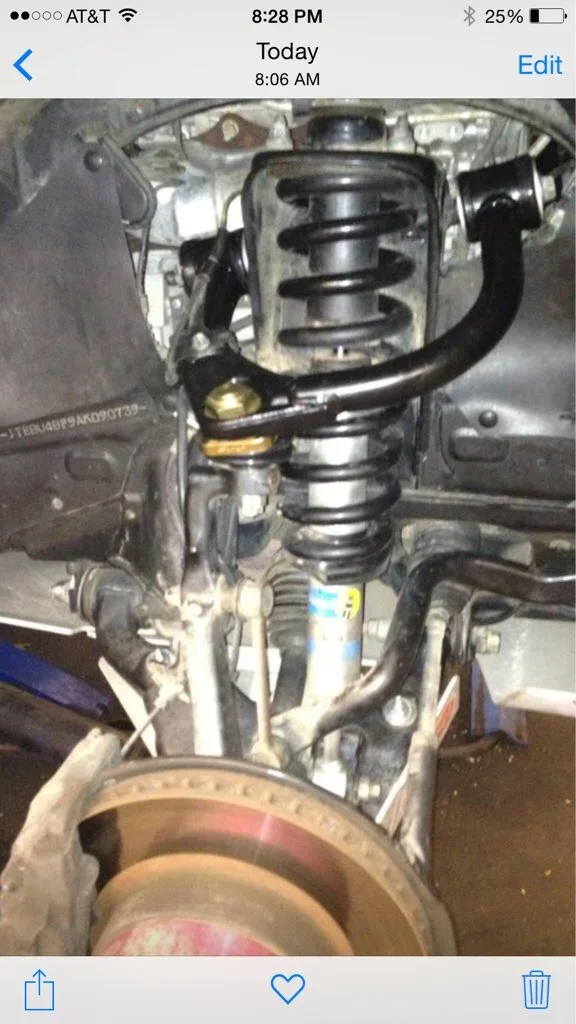

No only the Bilstein's at 3" lift! If you spend $450 for the Light Racing UCA 's the adjustability is great! I only speak from experience with hundreds of thousands of miles on and off road with the setups on Toyotas ! ImageUploadedByTaco Forum1431046679.346615.jpg
That adjustable nut does wonders! That's what she said!

No only the Bilstein's at 3" lift! If you spend $450 for the Light Racing UCA 's the adjustability is great! I only speak from experience with hundreds of thousands of miles on and off road with the setups on Toyotas ! View attachment 5595
