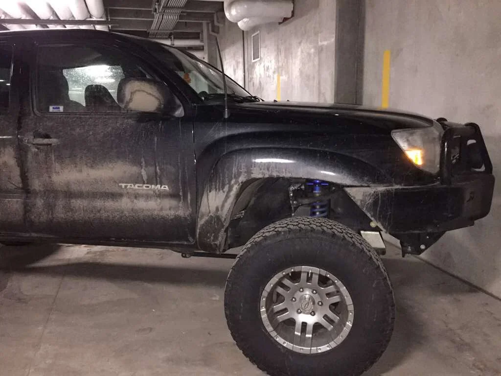

With 6" you'll be able to run 35s no prob
