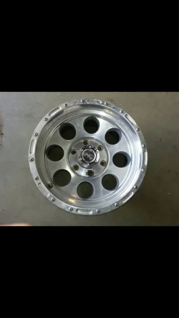

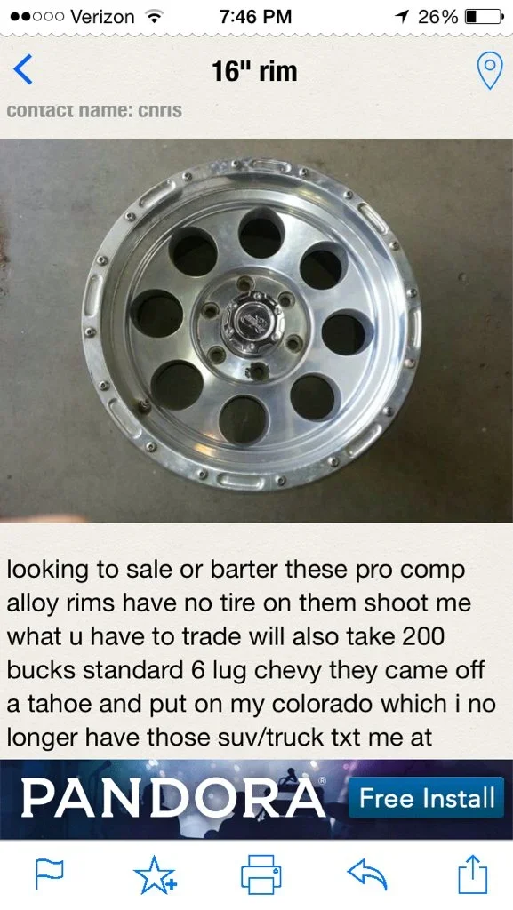

Looking to buy rims on Craigslist and found some that are 6 lug but the guy said it came off a Chevy Tahoe. I know there are spacers for this but will that effect the ride after? ImageUploadedByTaco Forum1406343177.350504.jpgImageUploadedByTaco Forum1406343191.317487.jpg

Also just found out they are 16"/10" is 10" wide too wide?

Rims were 16/8 with a zero offset I believe. Bolt patter was the same just not the bore, I think spacers will work to clear it but my concern is if this will ruin the ride for example wobbling. My stock rims are a positive offset 16/7.

Then he's stupid, lol. Yeah the 16x8 will work fine, I would know since I have 16x8 upgraded from the stock 16x7s, and you don't need any wheel spacers
