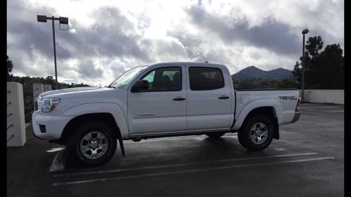

Have 2014 trd taco. Looking to put some 285’s on there but don’t know weather I should go with a 2” or 3” lift. And what lift recommendations for that setup? And what kind of lift? Please help a brother out. IMG_5325.jpg
I have 285/65X18 on my 2015 dbl cab 4X4. Toytec 2 1/2" lift. Removed mud guards. Minor rubbing on frame with full turn. Wheels are a +12 offset.

Lots of people put 2.5-3” lifts on and run that size tire. The closer to 2” the more rubbing you’ll have. If you’re 4x4 new coils, shocks and an AAL would be the best cost effective route. I wouldn’t get spacers and I wouldn’t get rough country.

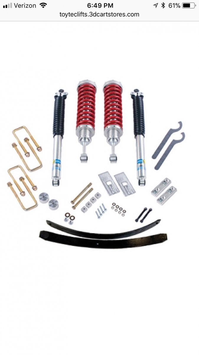

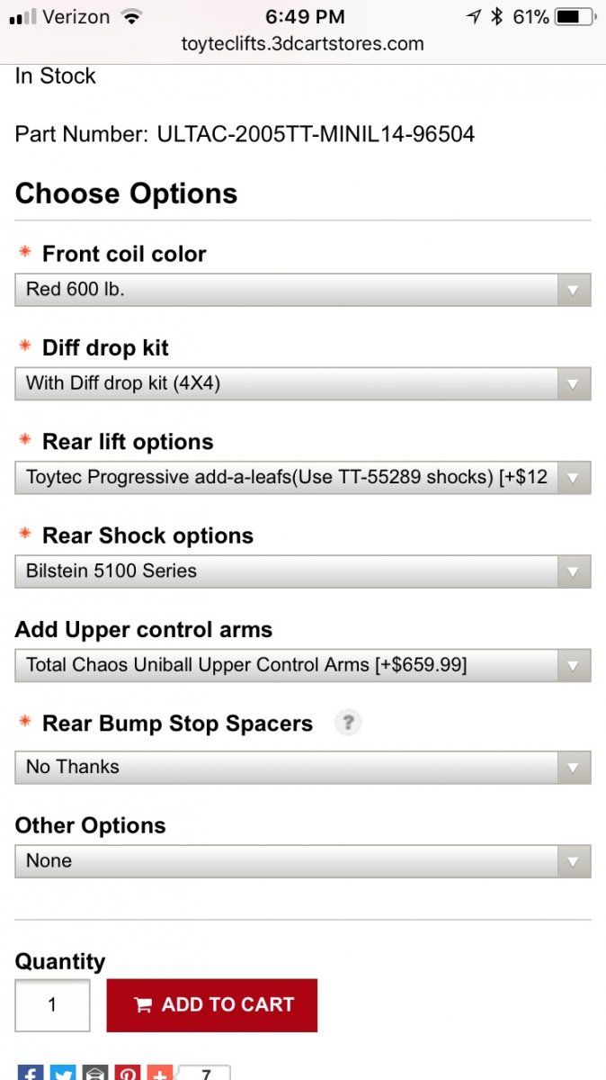

Thanks for this info! The link you sent me, do you recommend any of the upgrades offered on those drop down options? I really appreciate your help!
The Toytec Boss 0-3” with AAL are a solid setup but I’d recommend adding the TC UCA’s to your order as well.

It depends on who you ask. Haha! Progressive leaf backs are a little better than the single AAL. I had a set of Toytec Bosses on a Tacoma once upon a time. I liked them. I have no experience with what @OR17TRD posted but if he recommends it you can bet it doesn’t suck. lol
The drop down upgrades all depends on your needs. They are mostly for added weight like bumpers and winches. You probably won’t need the drop diff.
