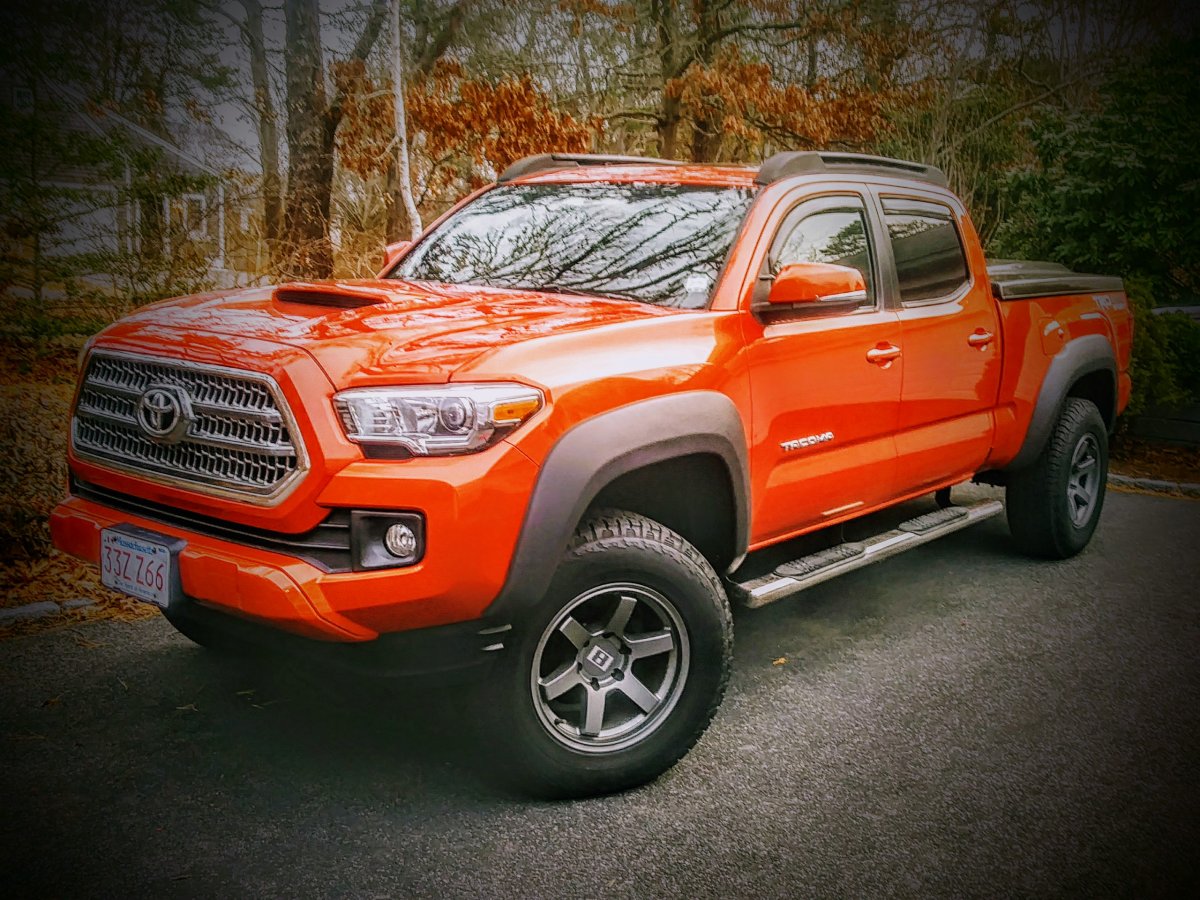

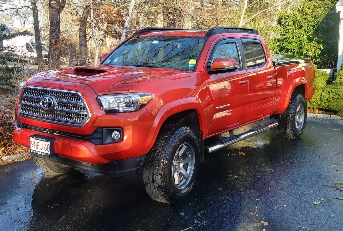

20200308_170545_HDR~3.jpg I have Level 8 rims 17x9 , 4.5 backspace , -12 offset I probably should have got the 17x8 with -10 .but I still like them. Its just a 265/70/17 looks a little wimpy on a 9 inch rim .Hankooks dyna AT.love the tires got 20k and the tread looks new and I put bigger flares on it recently.And take a look at the same rim in a 16" ,it looks a little tighter.imo not going to use 17 inch wheels again there is not as many size options as 18" or 16" :)
