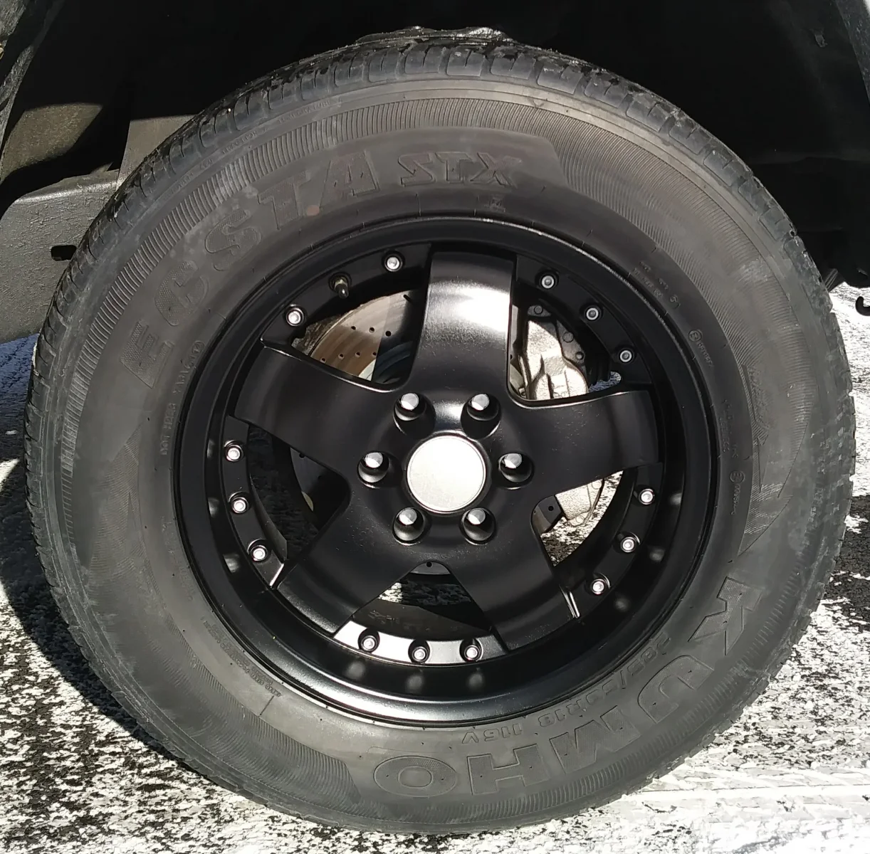

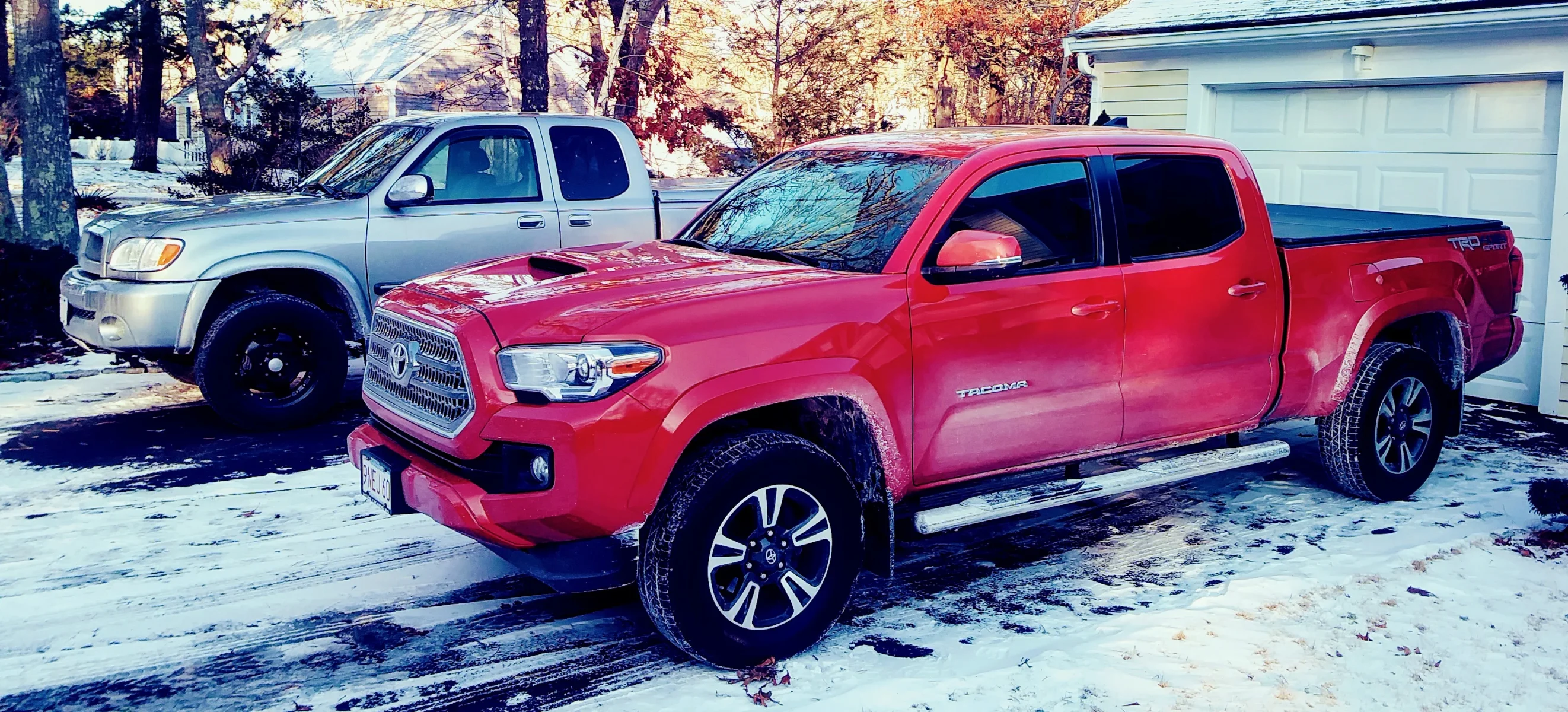

No its a sport I could find any off roads with big cab and long bed I do carpentry and needed size they are pretty rare in New England . I'm hoping my wheels from the tundra will fit they are 18 x8.5 Modas with 4.5 backspace . they fit the tundra with out the lift so I'm hopping they will clear the taco. 30.5 tall 285/60/18 kuhmo
No its a sport I could find any off roads with big cab and long bed I do carpentry and needed size they are pretty rare in New England . I'm hoping my wheels from the tundra will fit they are 18 x8.5 Midas with 4.5 backspace . they fit the tundra with out the lift so I'm hopping they will clear the taco. 30.5 tall 285/60/18 kuhmo
You’ll be ok in the rear the front is where you might have some issues with rubbing. What off set are they?

If the Tundra wheels are at least +13 offset down to a 0 offset you should be ok. You might need to put some bilstein 5100’s on the front and level the rake out.
I have to check maybe an inch its not much they didn't rub on the tundra before the 2 in lift we´ll see if they fit they will look nice on it.
