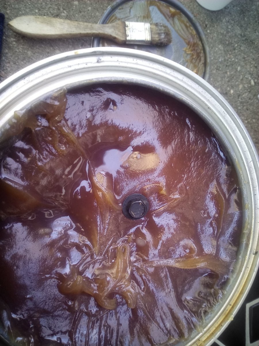

so far this product i stumbled upon (HV WoolWax) has been decent for adherence to most every part of my rig EXCEPT for that 3rd member and driveshafts, it sticks on body panels and protects those wheel-arch molding screws that get crusty. as long as i don't hit it with a soapy wash-mitt it resists the low-pressure rinse at the DIY wand wash
its thicke when its coldish
more pics coming...
