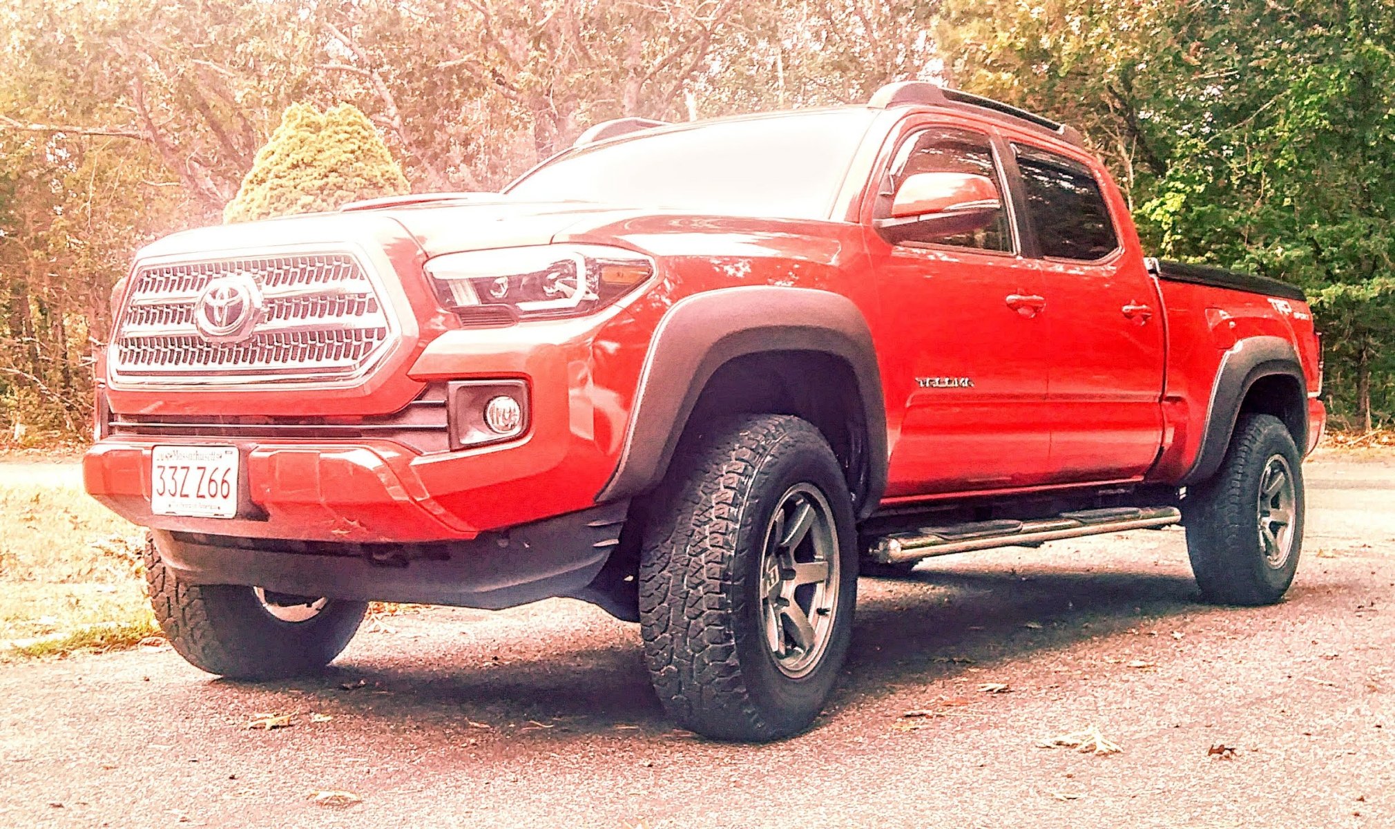

Cape taco
I love my trd long bed do cab '16 only issue was recall on thrird brake lite leak and cuz it leaked i'm getting new carpet and headliner from dealer in a couple weeks. I did just change out original battery last summer. Put in an Interstate. Guy said Interstate makes Toyota battery. 20221002_114500_Film3~2.jpg
