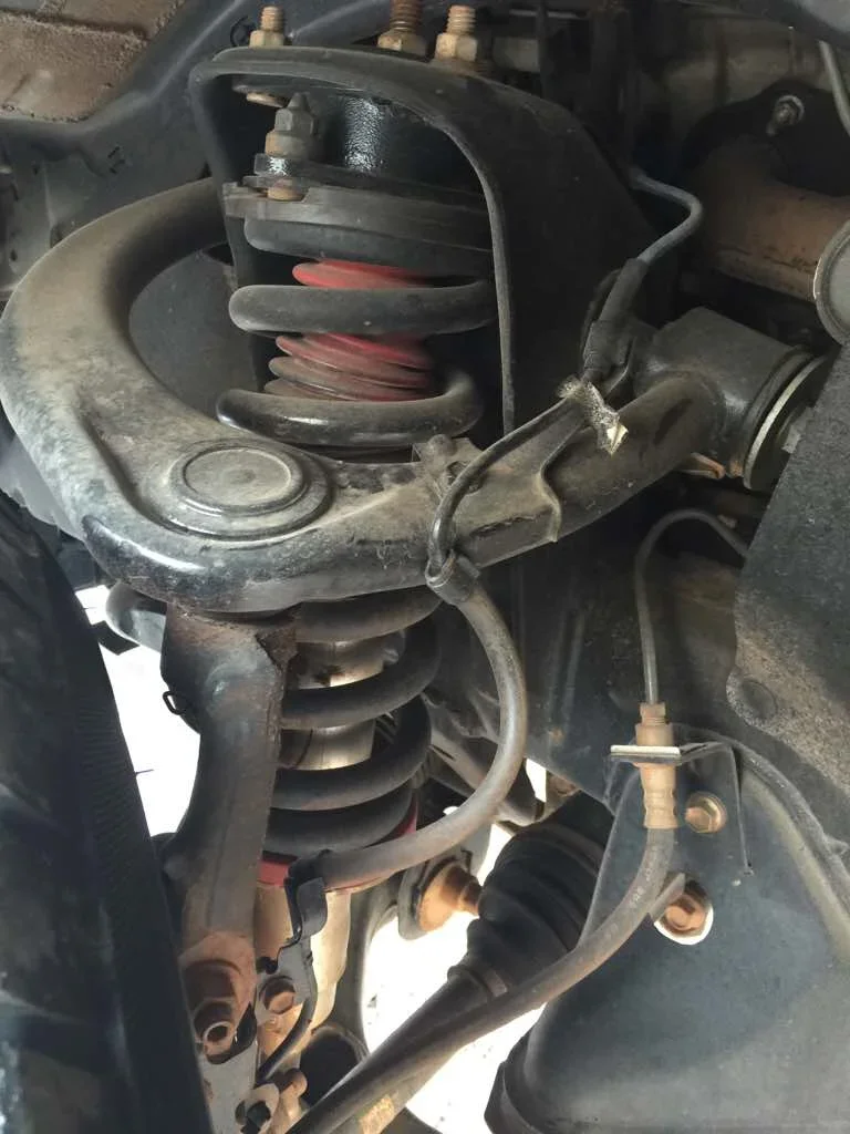

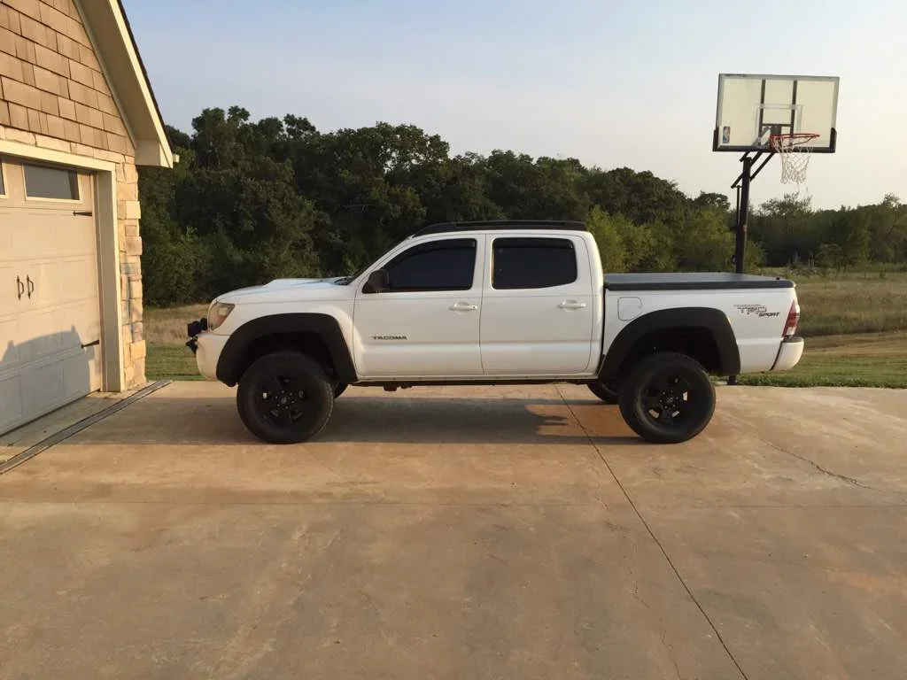

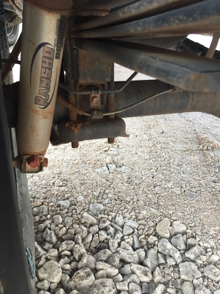

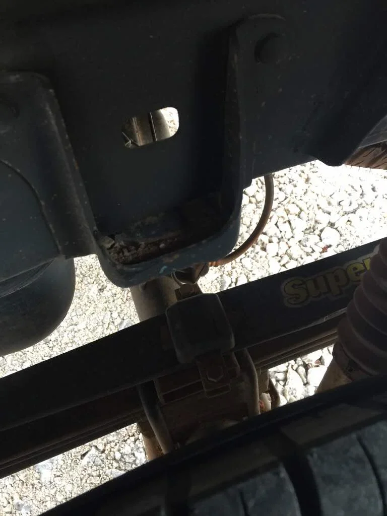

I just purchased me a 2009 Tacoma and I have a few questions. I think my truck has a small lift but I'm not sure if the blocks are after market or factory. I know it has helper springs. I'm wondering if I can run a 33" tire with my set up. ImageUploadedByTaco Forum1441245824.784751.jpgImageUploadedByTaco Forum1441245843.067350.jpgImageUploadedByTaco Forum1441245857.352831.jpgImageUploadedByTaco Forum1441245869.354345.jpg
Blocks are aftermarket, you'll be fine in the rear, you have a small, maybe 1-2" spacer up front, you might be able to fit 33's up front, it'll be tight, but you'll most likely have to trim and cut some stuff..

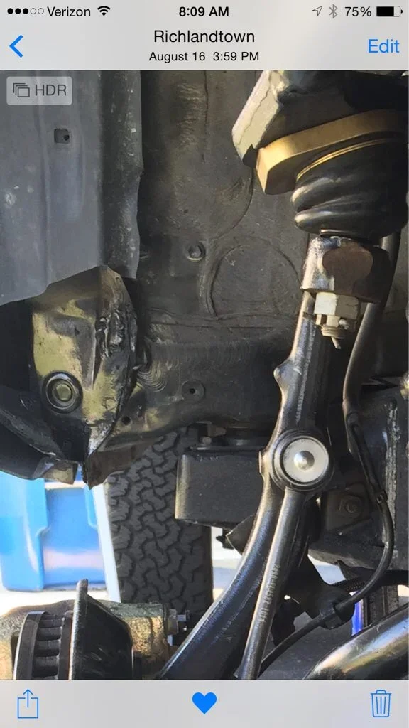

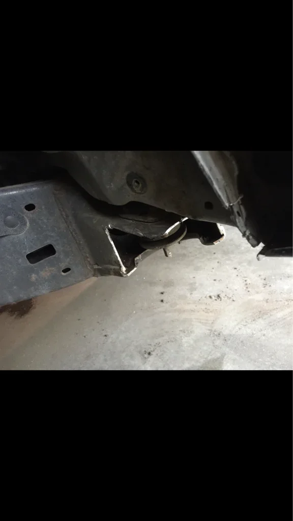

I say no you won't. Body Mount Chop at the rear of the front wheel well is needed and I needed 1 1/2" wheel spacers to push my factory sport 7 1/2" rims with 285/70-17 away from the upper control arm. ImageUploadedByTaco Forum1441281993.459110.jpg

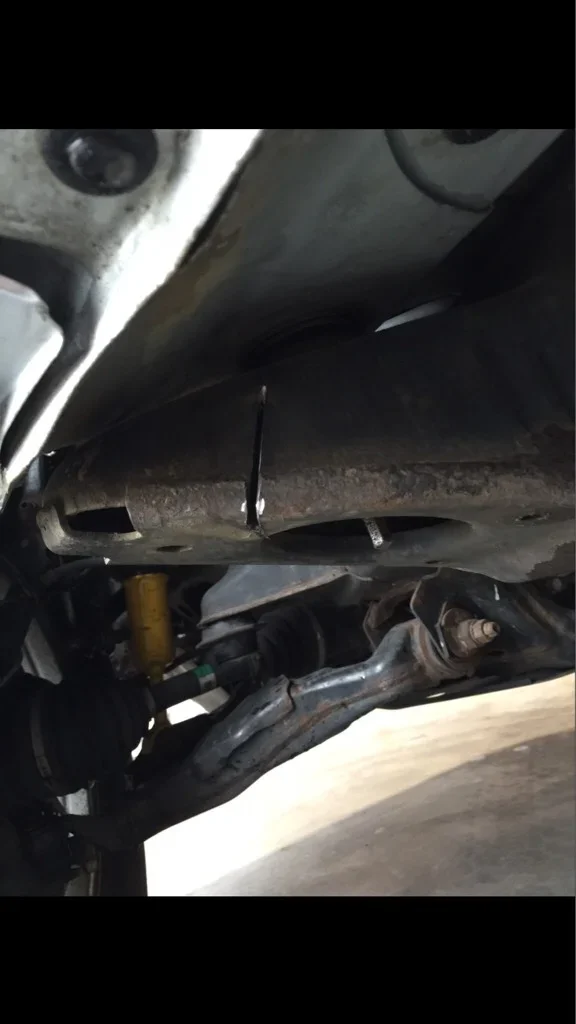

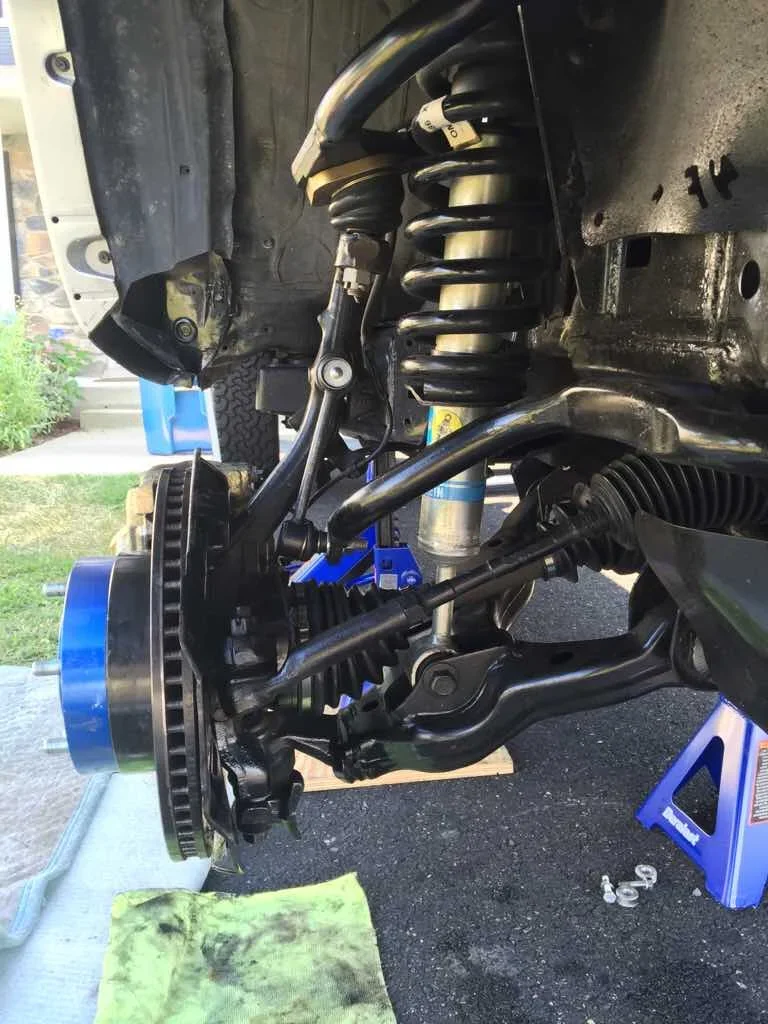

This is one side completely rebuilt with all new components.ImageUploadedByTaco Forum1441282066.285407.jpgImageUploadedByTaco Forum1441282080.770377.jpg

Body mount is almost square in the middle of this pic with new steel plate welded over part I cut off and new paint.
