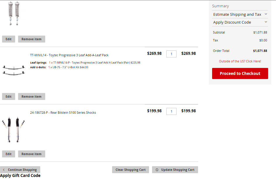

Is this an accurate cart of what you recommended? Appreciate the quick responses and welcoming as well.
Let me know if I missed anything. Not sure what to do about rolling around on stock wheels. . . while lifted.

I cannot tell what those coilovers (front) are.
if those are the "ultimate" setup, they are **** set at 3" of lift, I dont know if they are any better at 2.5"

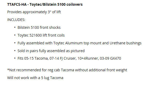

can u give me a link to those front coilovers?
oh, and I forgot, unless you are using threaded coilover bodies, you should get a 1/4" spacer for the FRONT DRIVERS SIDE ONLY, as the oem coils are side specific due to added weight on the driver side. Over time the stock setup starts to lean to the drivers side still.... Aftermarket coils are NOT side specific so the "LEAN" is exaggerated.

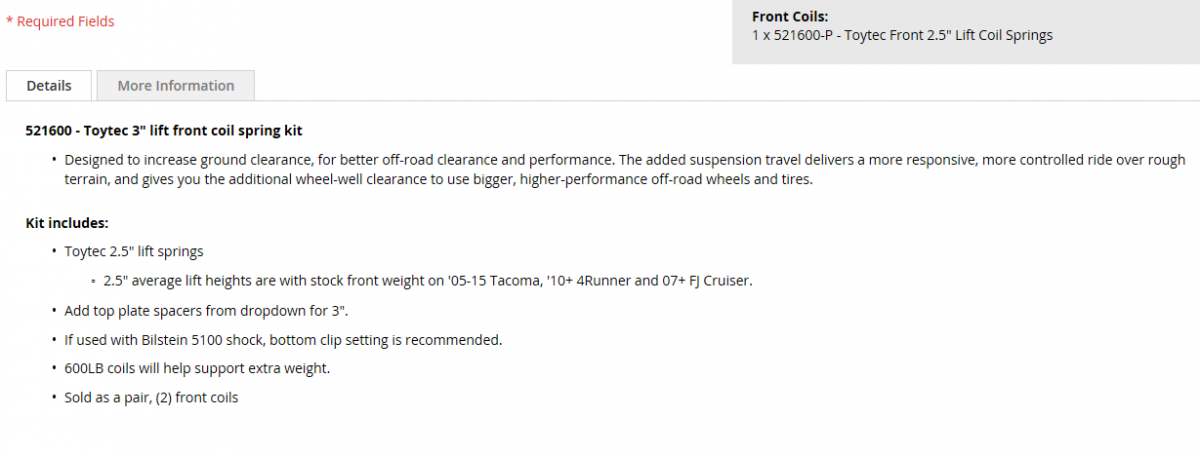

This is the link. It said lifted front coils. Again I'm not familiar with this so appreciate the help.

those are the new coils for 3" of lift if i read correct
Id suggest different coils............ Im sure SOMEONE has the 2.5" OME coils combined with 5100s and can chime in
plus ONE of these for the driver side lean
https://www.toyteclifts.com/tp14-front-top-plate-spacer-one-1-4-thick-spacer.html
This is why it makes us new guys even more confused. I found this to be the lift coils on that setup.
It says 3" lift and then the coil says 2.5" which is what I want.
I guess you can add a spacer to get the 3" which I would not do for my setup, right?
I see, that should work for the front then. I missed that, good yob
U will need a 1/4" spacer for the drivers side still... But thats it and u should be even side to side

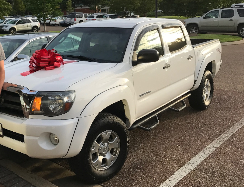

I'm confused by this a little. I think my stock wheels are 265/70/16 without a lift currently that I am aware of?
If I lifted it 2.5" can I not fit a bigger tire than the 265's on the stock rim? I have no idea how to find the offset of the stock wheels.
I assume by changing to an aftermarket that lets me change the offset so that it will work with a 285 tire?
Maybe it isn't stock? I will upload a photo.

Stock tire size is 265/70/16
285 wont fit without cutting and modifying the cab mount as far as i know. I havent bothered looking into new rims or 285s for a loooong time, im content with 265/75/16 on stock rims.
