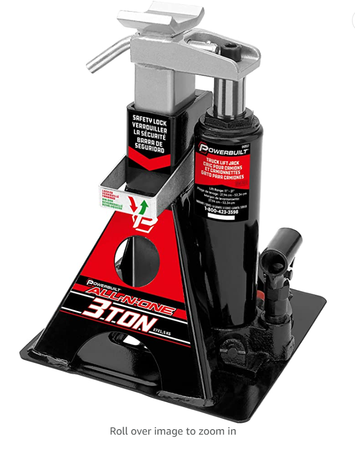

The Powerbuilts are nice. I bought one to try out and it works as advertised. Two issues. First the thing weighs over twenty pounds, it might weigh even more than my Hi Lift. Second it is very bulky. They are great for the garage though.
