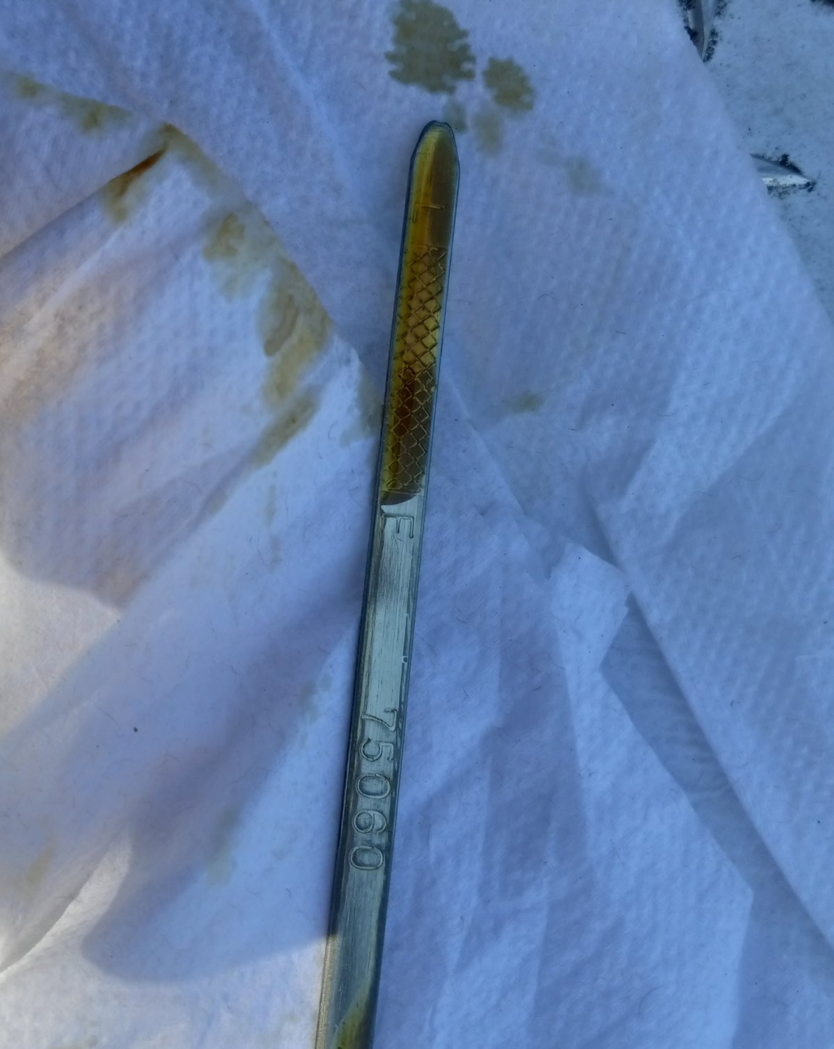

Okay this is the dipstick hopefully you can see it's almost perfectly on the full mark with 4.5 qts. This is 1,000+ miles since the oil change.

Thats not any type of tacoma dipstick I've ever seen....it looks more like it came from a honda. You need to buy another dipstick thats for a Toyota Tacoma. Every tacoma dipstick usually has a low mark, and another higher one that you'd normally want to see the oil between the two marks when full.

The truck has had the dipstick since it was new, don't think Toyota would put a Honda dipstick in it. They could've inadvertently installed a Corolla or Camry dipstick in it I guess?!?!
Not saying for sure it's a honda dipstick, only that it resembles one. Every Toyota dipstick I've ever seen were different from yours.
I did run the part number in your pic, and it does check out as a 2.4 tacoma dipstick. Its very strange toyota used a dipstick as such.
Well, the next time you do an oil change, make sure you drain every bit of oil out, then add 5.8 quarts including the new filter. Run the engine on a level surface, and check the oil level on the stick several times. Then file a mark in the dipstick where the oil level is, so the next time you'll know when it's full.

Okay I didn't mean to imply that you were saying it's a Honda dipstick! I guess they used somewhat different variations in dipsticks on these trucks. I know you posted that you found other forums where people said the capacity on their trucks were at least 5 qts. The ones I found people were saying the capacity on their's were 4 qts on the low end to others saying 5 qts. and I saw others that were also saying 6 qts. on their's!
