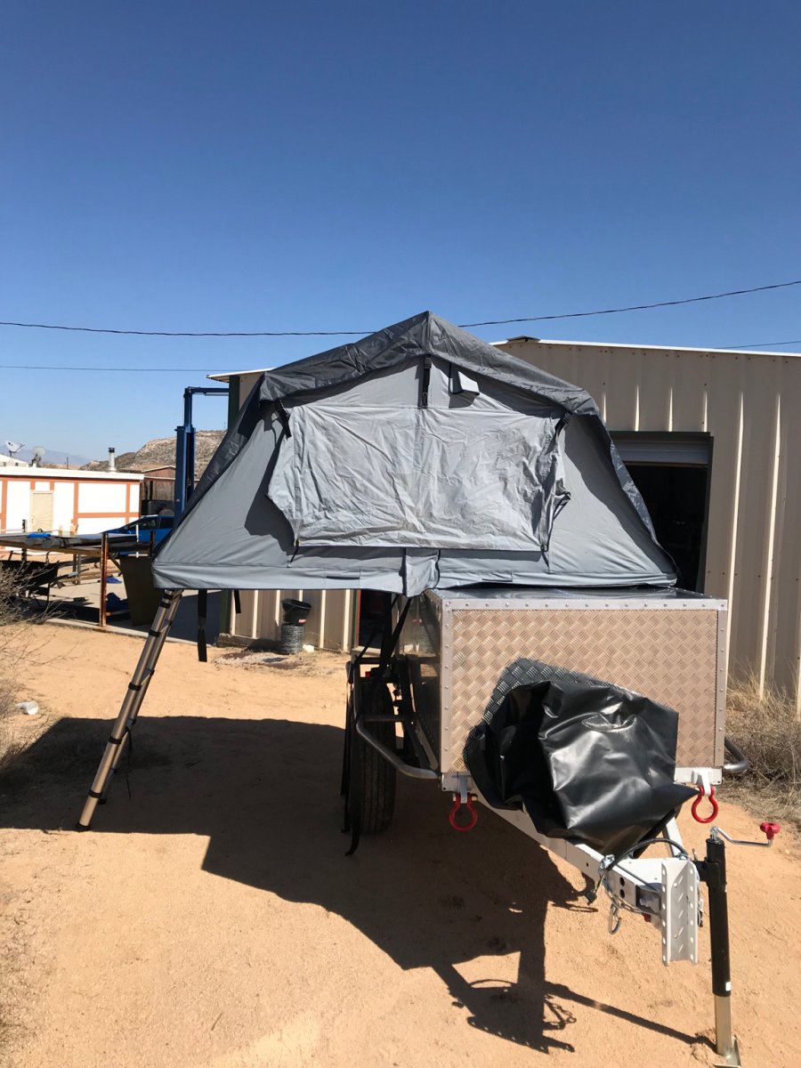

In all honesty I would put all that on a trailer and leave the truck unloaded. My buddy is going through all this again right now because he didn't want to get a trailer from the start. The truck sags so he want's to put leaf springs on it but can't because the King shocks don't allow for much lift. Just trying to pass on my advice but in the end it's your call.

If you don’t have the money to do it right on the truck a trailer would be a great idea but not the easiest to overland with.
