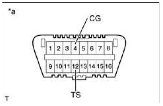

So, after much reading and terrifying results after inserting jumpers into various holes, turning keys off / on in different sequences, inaccurate videos created by loons, repair scams, and testers that were unreliable at absolute best, I took a deep breath and went with common sense. All my data pointed to codes that didn’t make sense together, so I did a ECM reset and zero point calibration. This is the best video I found. It’s simple, accurate, and it worked.
The pic of the ODB is accurate for my 2011 (pay careful attention to orientation, and double check to make sure this is your truck’s configuration). I drove a lot of miles to test everything out and so far it’s holding.o_O
