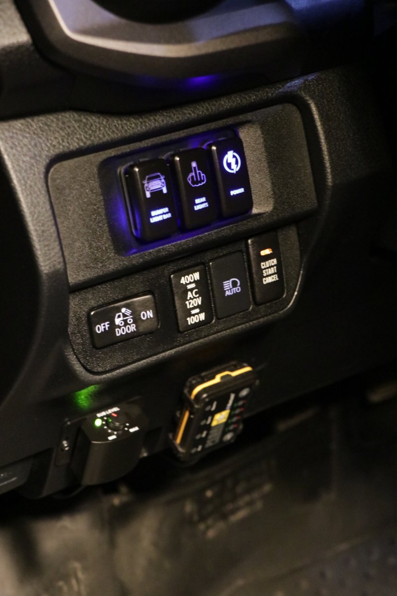

Here are my thoughts on the pedal commander. Imagine that the accelerator operates from 0-100%. The stock pedal eases into the first 25% or so but becomes more aggressive as you increase the % of acceleration. NOW remember I am basing this on a Manual transmission so the effected results may be different on a AT. First there is a considerable effect on the accelerator. I was hoping for results that make the truck feel like a traditional drive by cable without the drive by wire lag or programming. Instead, it feels like the accelerator jumps from 0-25% very fast. Obviously the more aggressive the setting the faster this happens. In sport or sport+ mode it makes the 0-25% so fast that clutching feels jumpy. I am saying 1/8” movement of the pedal feels like 1/4 throttle instantly. SO do I regret the $299.00 purchase? NO. Do I use the commander daily, NO. Awesome for off-road aggressive response or whipping a $hitty in the snow but overall the progressive response vers jump is better for every day driving. Remember this does nothing for you except increase response but it truly seems like the progression of the response could have been programmed better. You can see how I mounted mine. Again NO regrets just thought about how they achieve the no lag thing. 10784899392_IMG_5574.jpg
Cool. What does the Tampa Bay Lightning switch do on your set of controls?
