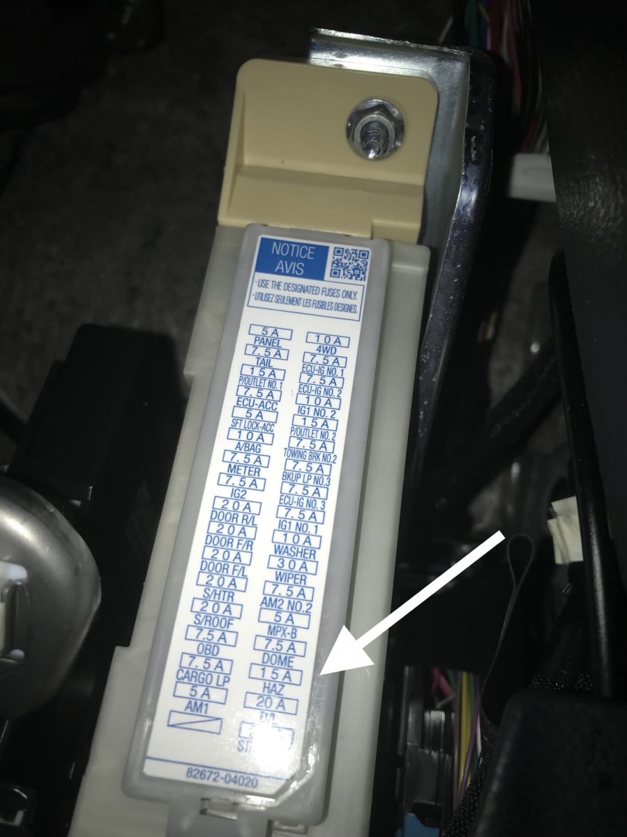

I was changing the dome lights inside my 2018 tacoma
I think i blown a fuse but i cant find which fuse to check
I dont have lights now inside my truck
Plese help
Picture of the fuse would be great
Thanx

I had to run down to oreily and buy a fuse
7.5
All good now working great
Like @OR17TRD said, it’s always good to pull the fuse before changing bulbs, or at least turn the dome lights off before changing.
There is a fuse puller and a couple spares in the fuse box under the hood. There isn’t a 7.5 though. A 10 would get you through in a pinch but I don’t like running a larger fuse.
I bought a set of spare Bussman ATM-LP fuses to keep in the truck for this reason. You never need them til you’re already SOL.
