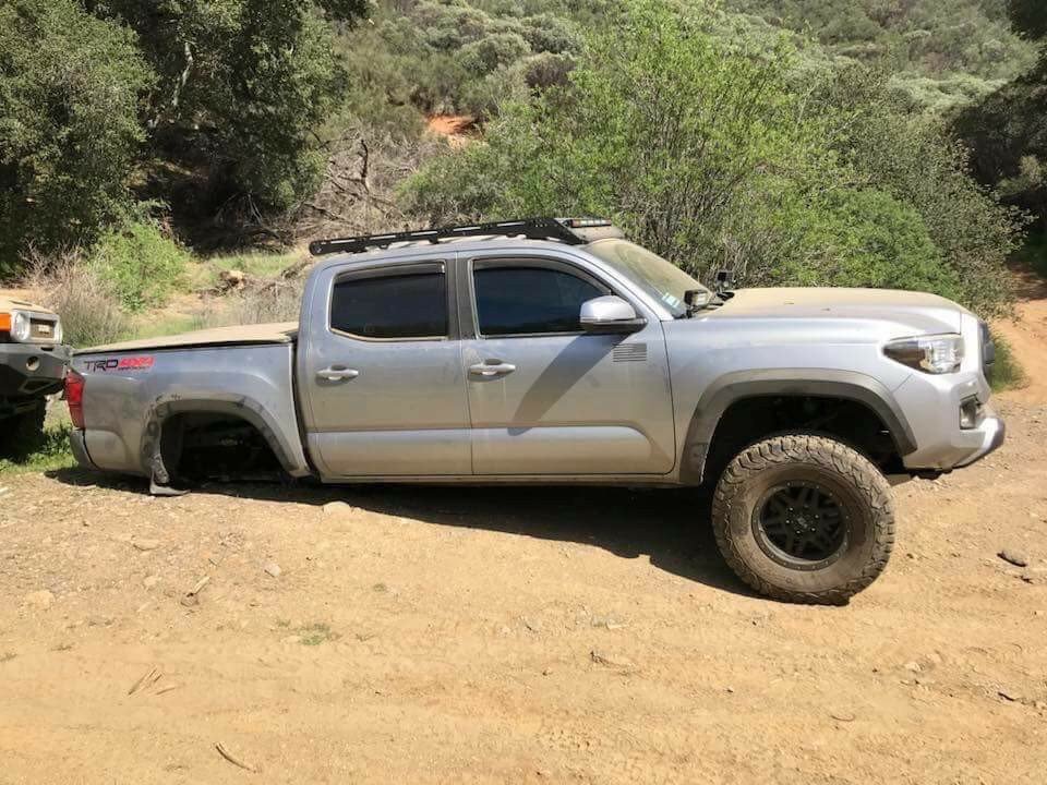

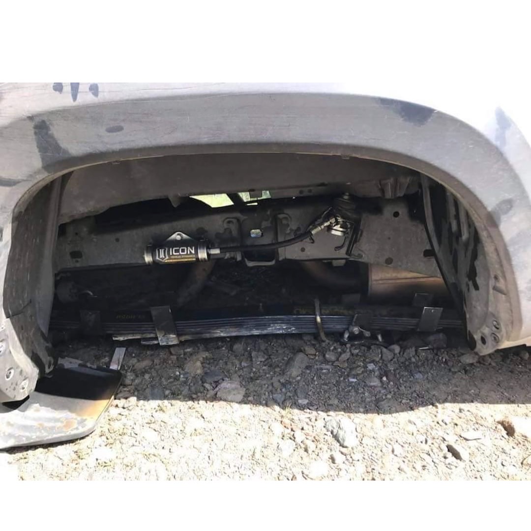

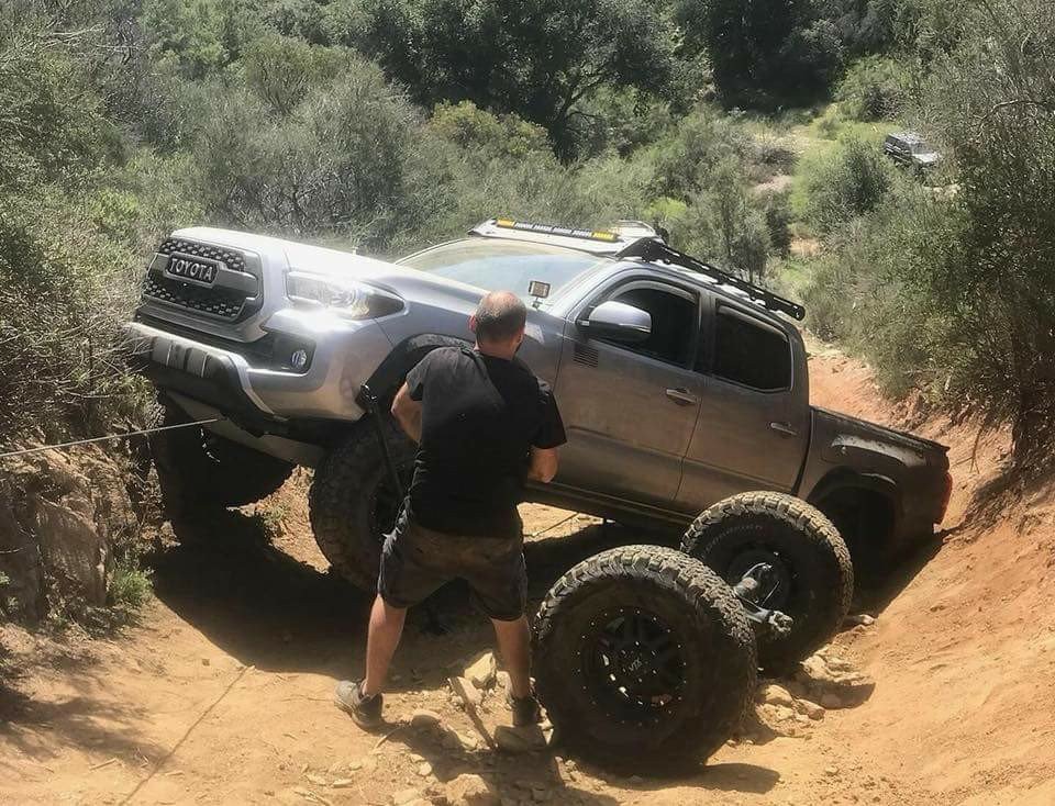

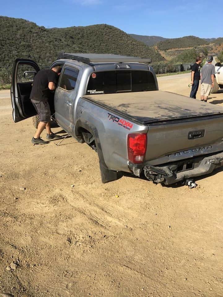

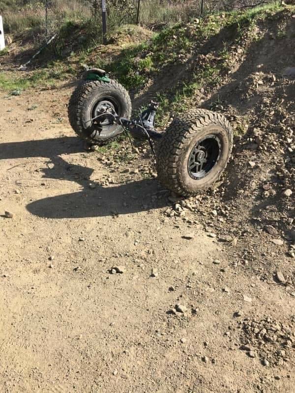

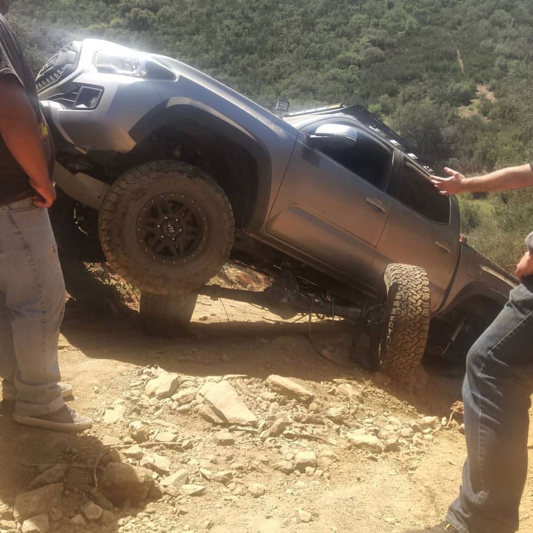

Not entirely sure what was going on here. My guess is the owner had a U bolt failure so they were recovering it but they chose not to secure the axle in any way. You can hear the tire already rubbing on the fender before the axle fully gave way. They could have used ratchet straps to secure the axle temporarily or a trip to the auto parts store for new U bolts if that was the issue. Again, I'm not sure about the exact details of what went on since I wasn't there. Brake lines ruined, wiring ruined, shocks broken, rear bumper damage and possible leaf spring damage.
If you wheel, have proper recovery points and go with someone that has knowledge. There was no need for this to happen.
Every time you pull someone out the first thing you tell them is “hey take your e brake off” the next thing you tell them is keep your ****ing foot off the brake man!” The last thing you tell them is straighten out your wheels and don’t turn them until your told”
