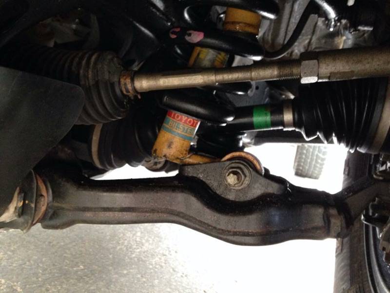

If ur gunna be out in the field using the truck, u may wanna rethink spacers.
Many a snapped shocks have happend
Also 275 is 10.8” wide and you’re putting them in 10” wheels. Don’t air down when you’re off road. You’ll blow a bead and spin a rim in the tire.
It really is amazing how weak the disposable struts are,...View attachment 18895
Well when you change geometry and the shock becomes the bumpstop, **** breaks.
Its not toyotas fault, nor bilsteins.
Id say its on the spacer manufacturers part for not telling ppl about this.....
the installers part for not educating the buyer......
The owners part for not doing more homework.
Or any combo of these.

Precisely. Not blaming anyone. The spacers were on there when I bought it, so I ordered real stuff and went out playing for about 7 minutes until I destroyed the shocks. Lol
