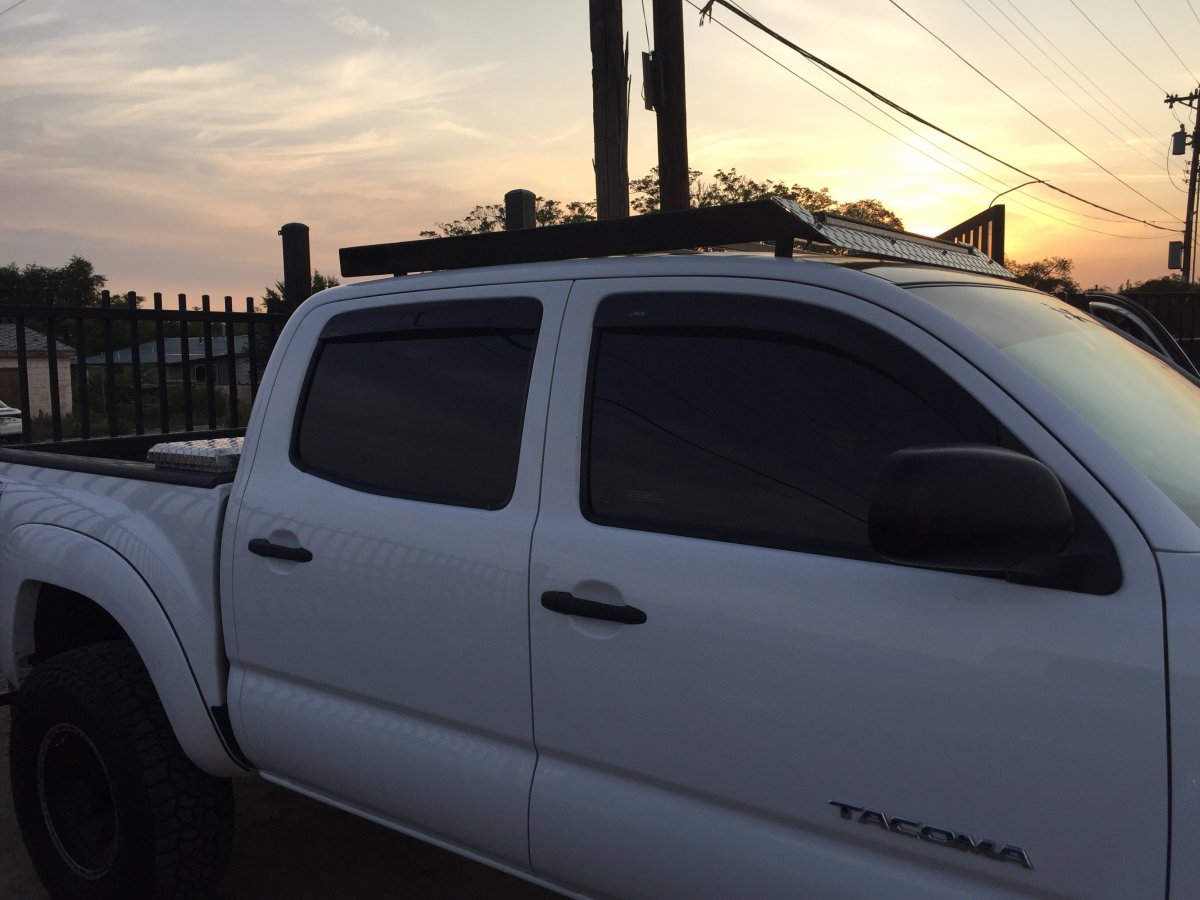

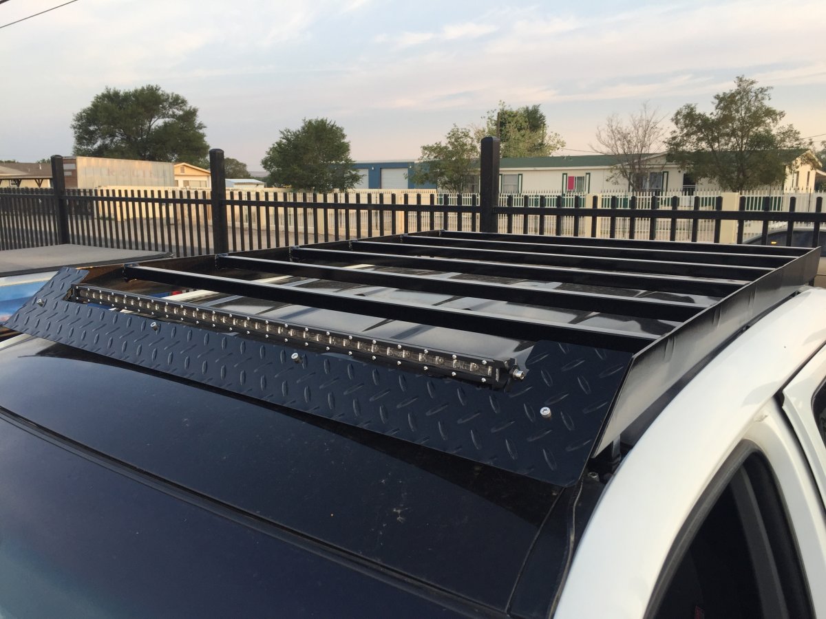

Planning to make my own roof rack soon seeing if any of you know the thread size of the factory roof rack holes so I can get me some bolts to get this thing startedIMG_9576.jpg

M6 with standard 1.0 thread pitch the length will determain what you are trying to attach wether it will be 14mm or 35 mm or how ever long you need.
That will screw into the factory holes.

I did have to remove it and cut it to fit back in my gaps. The front and back have clips so up front I did not put anything it just sits nice and snug in the seam. In the rear they use double sided tape on the rounded part of the cab. The small pieces I have up top sit snug but freely in the seam. So no I didn’t use anything to stick it to my truck. I’ve been on highway trips and they have stayed in place.
