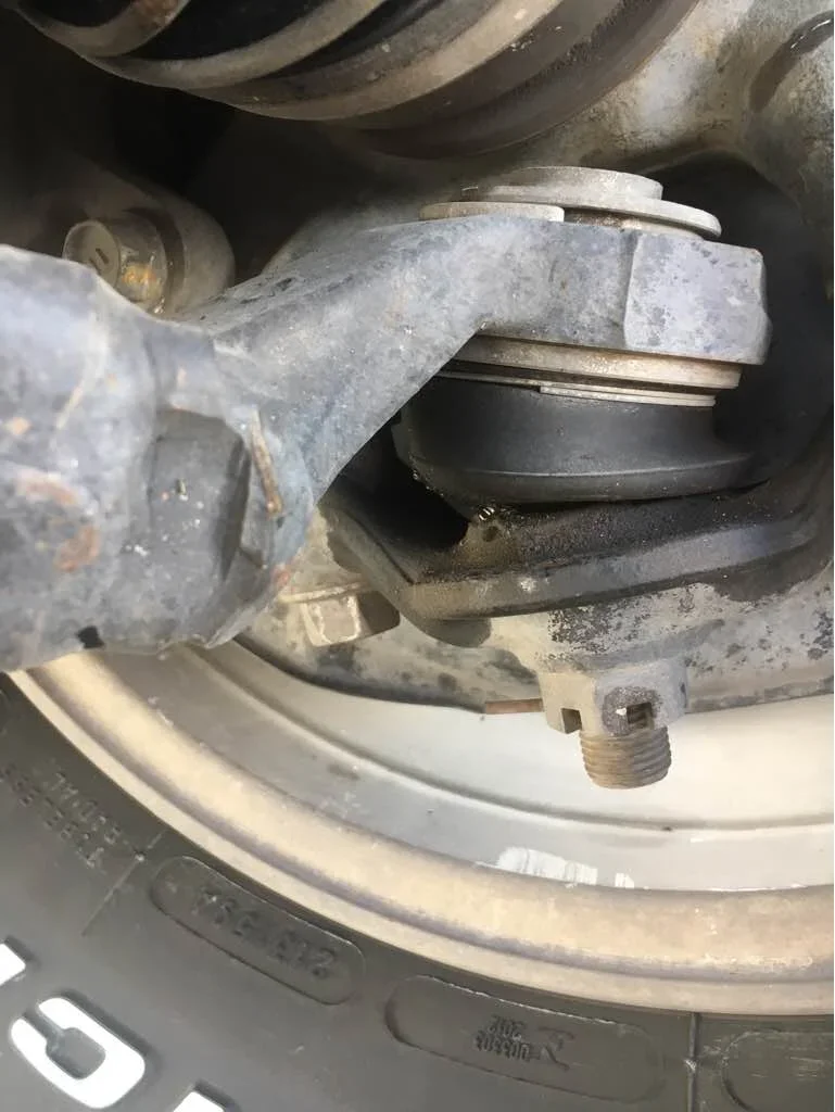

I did a halfass alignment on it temporarily until i can get it to shop. It doent rub now. And yes still clicking. Almost sounds more like a squeak. And just about 4 days ago something started to pop occasionally when i turn sharp or brake hard. Just a single pop. Im thinking it might be my lower control arm ball joint. They both appear to have grease coming out of the rubber cover. ImageUploadedByTaco Forum1496604720.027610.jpg
I did a halfass alignment on it temporarily until i can get it to shop. It doent rub now. And yes still clicking. Almost sounds more like a squeak. And just about 4 days ago something started to pop occasionally when i turn sharp or brake hard. Just a single pop. Im thinking it might be my lower control arm ball joint. They both appear to have grease coming out of the rubber cover. View attachment 11646
I see that.
Popping started before i installed ucas. I chose not to install diff drop. Could it be cvs popping?
An alignment shop, and good one, will be able to tell you exactly what you need. Maybe some previous owner bent something and it will never be right unless you change it out. But you should start there.
