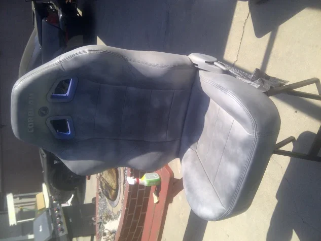

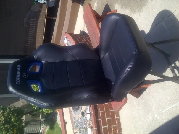

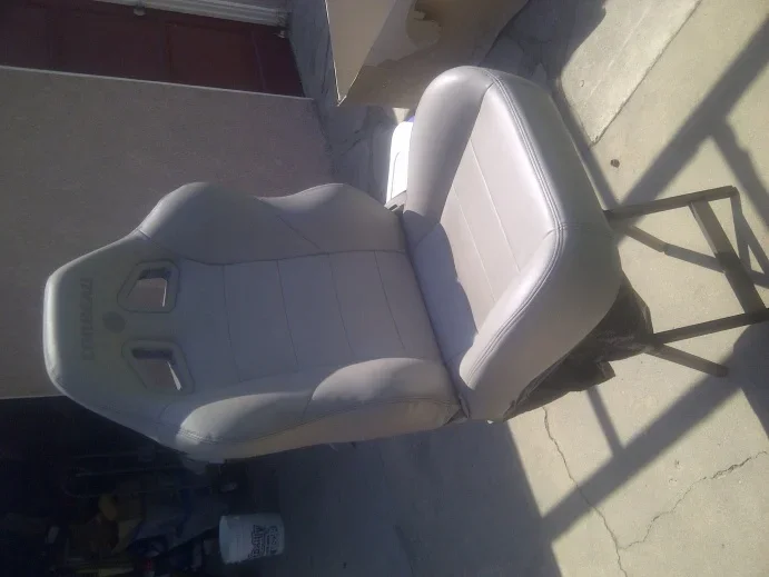

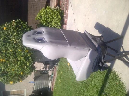

My friends over at one of the stores I go to gave me this returned Corbeau suspension seat. Only problem which wasn't really a problem was, it was black and my interior is gray. After some research, I found Color bond. Here's how it came out.

Nice. How long did it take and how many coats?

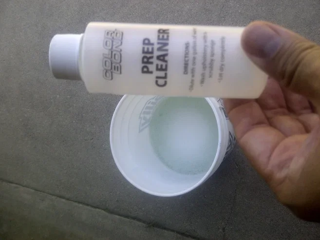

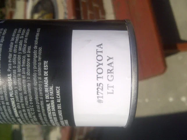

2 cans and the prep cleaner.
Took like an hour and a half. Each coat bonds and dries in 1 minute, but they recommend 15 minutes between coats. I bought the cleaner, but they said u can use acetone. I thought the acetone might be to harsh. 24 hours to fully cure.
Thanks whipersnapper
http://colorbondtuner.net/index.html
Looks good! But won't it eventually flake off?
Company says no because Its a dye not a paint. But we'll see I've never done this before. And it was either this or have them recovered. 35.00 for paint and the cleaner or 300.00 to recover it.:thumbsup:
