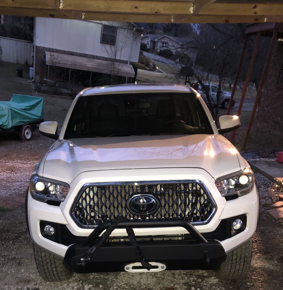

I installed the Warn Winch Bumper, for those that are skeptical it's really easy, much easier than I thought it would be. The hardest part is mounting and wiring the winch, I installed the Smittybilt X20 12000lb, love the wireless.
I cannot tell any difference of any frontend weight, it feels the same to me, The bumper weighs 73lbs and the winch weighs 60lbs. The winch functions excellent so far, I use it almost everyday since I do a lot of tree work, the free spool is so smooth and I'm trying to find another solution for the battery, I would like to go dual batteries but still researching.
I really like how Warn did their homework on this one, the bumper lines up just about perfect and it mounts solid.
BTW it doesn't interfere with TSS

Thanks, the Victory and the Warn look very similar and priced as well, I got 10% off of mine at Summit racing which came to about $72, after loading it into the truck I went back in and bought the winch which was about $700 with the 10% savings came to $70. They only allowed one coupon per customer.
