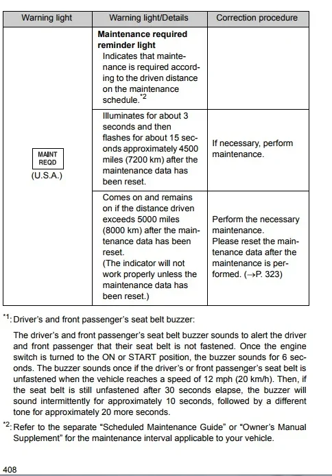

kp.taco Well-Known Member Aug 19, 2017 #4 maintenance required light comes on every 5k miles. It a good idea to rotate tires also at that time..

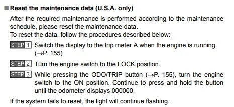

R rich Member Aug 25, 2017 #5 So does it stay on or flash when starting truck? Also I can rotate my own tires so how do I clear light?
whippersnapper02 Negative Nancy Aug 25, 2017 #6 Procedures for trucks with white gauges. It's the same for trucks with black gauges but you select ODO instead of Trip A.
