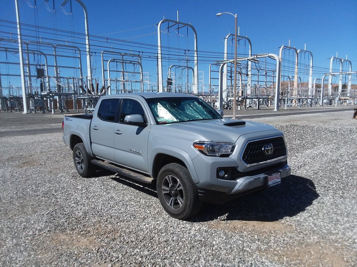

Just bought a 2018 cement color sport. I'm going to black out (dip) the Tacoma and V6 chrome as well as the fender flares. Not really digging on the TRD Sport graphic. Does anyone have pics with this removed and what's the best way? Also, is this some form of sacrilege in the Toyota world? I'm kinda surprised by how many people keep the graphics.

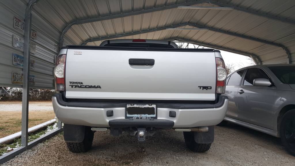

I removed the TRD Sport graphic from my 2011 taco in 2011. I now have a 2016 TRD Sport but left graphic on. I removed the 2011 with a blowdryer on high and start heating the edge of graphic . You will be able to start peeling it away. Takes a little bit of time but not really that big of a deal.

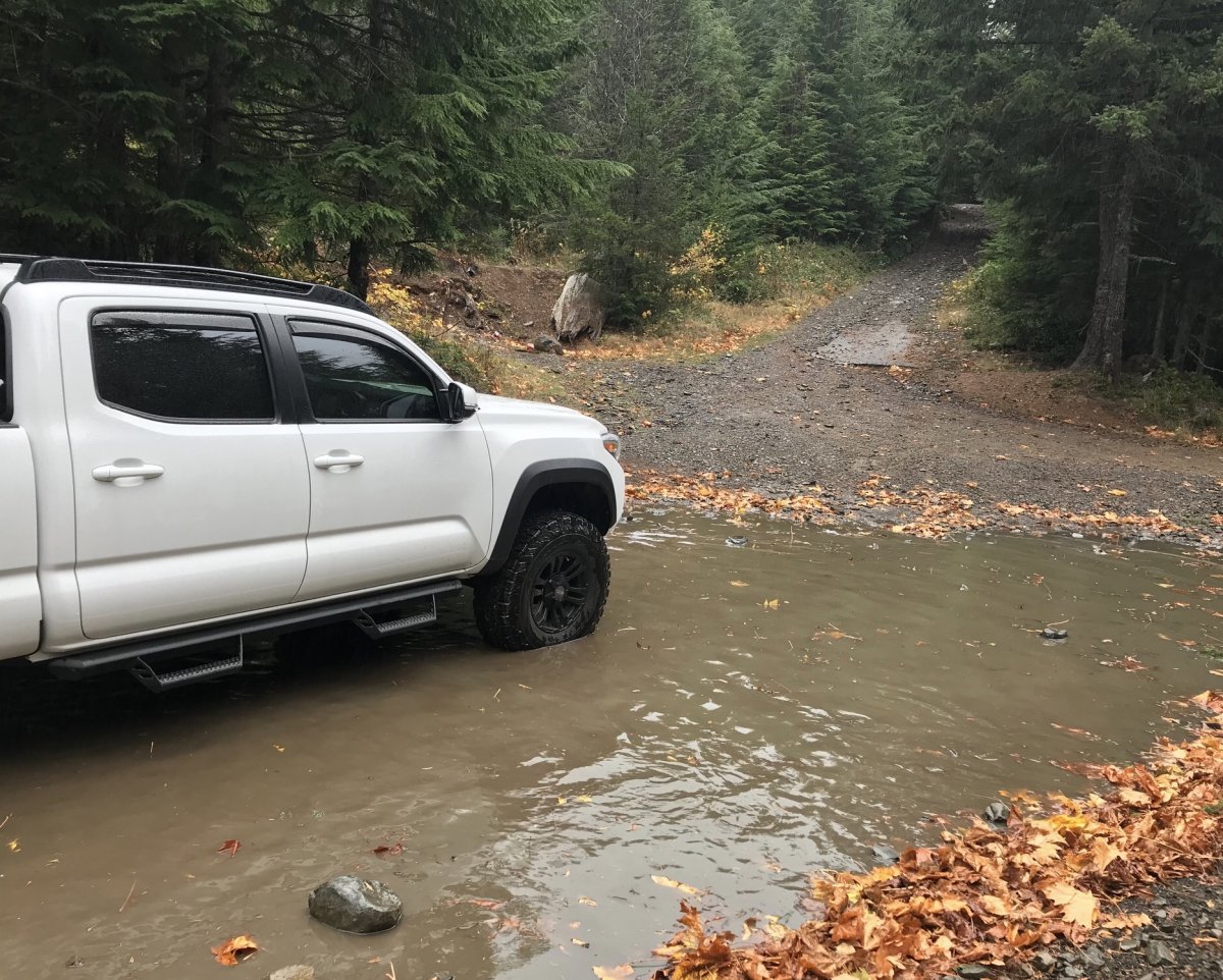

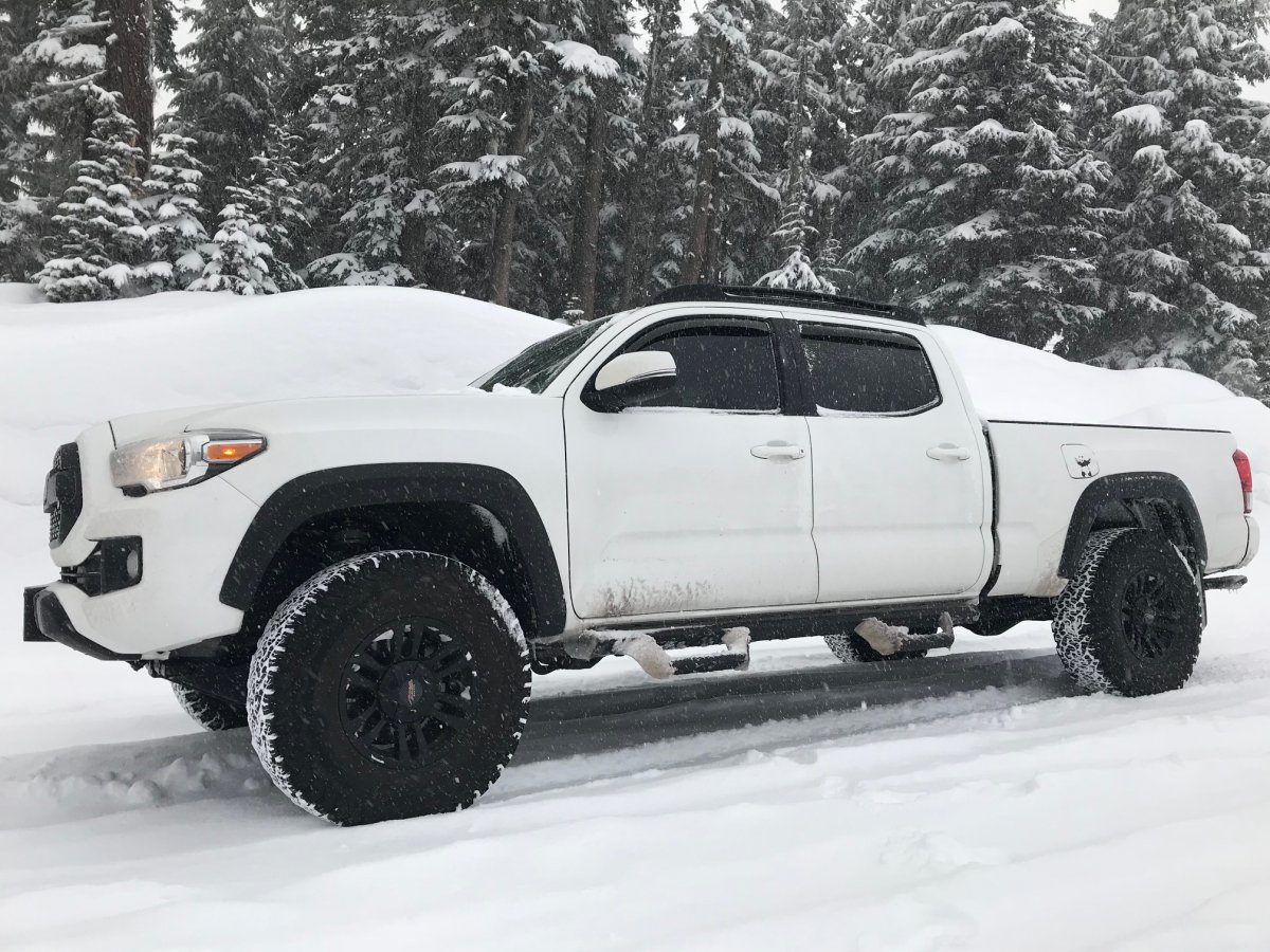

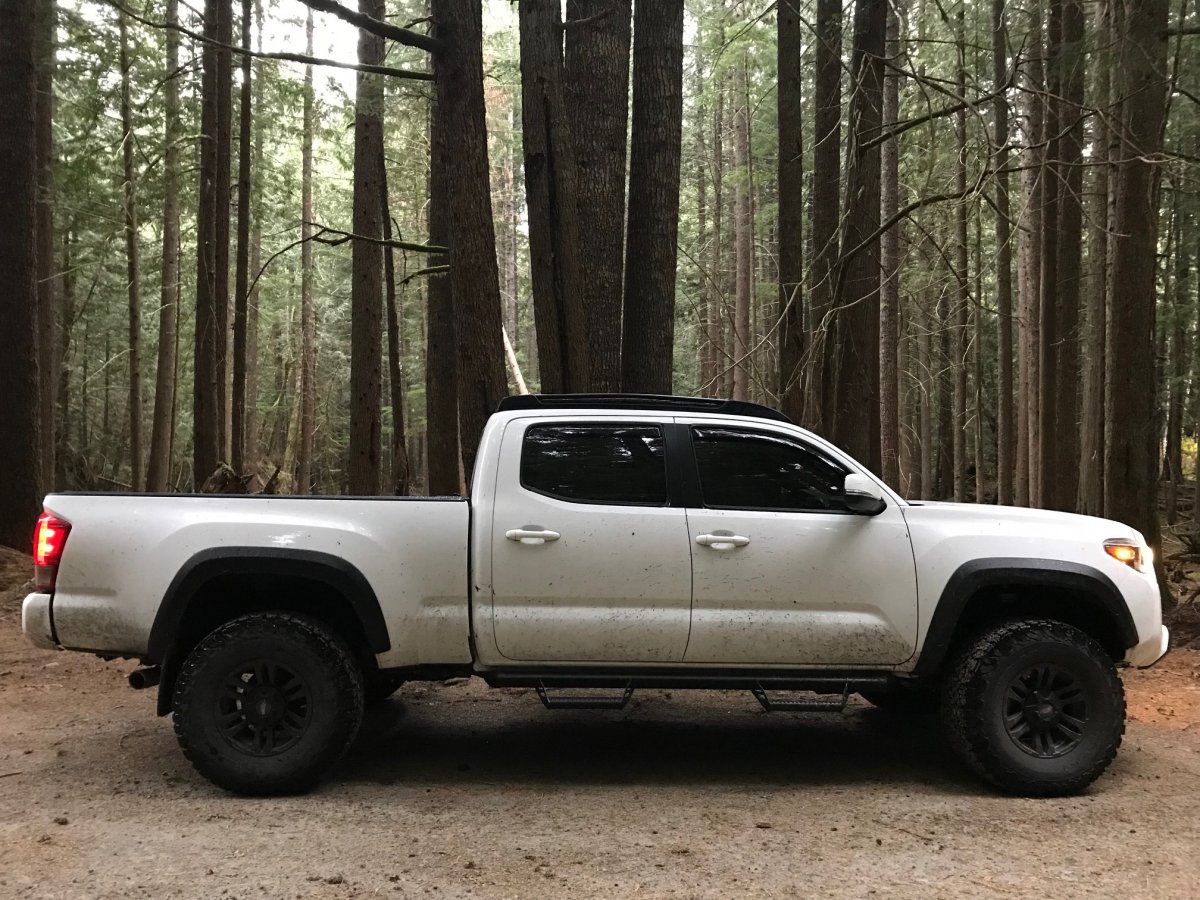

0AAC8118-A4E2-4BB5-9160-A2AB512AAFD3.jpeg 96FF37F9-DAF4-4E55-A2FB-7F2A011AD598.jpeg I took all the badges off mine. The V6 was gone in the first few days I owned it. I took the V6 and Tacoma badges off with a heat gun and fishing line. The TRD offroad sticker I did it on a warm day and just used my fingernail to start it. Once I got it started I pulled it up at a 45 degree angle and kept a constant and consistent pull at that angle until it was off. There was hardly any residue left over. I used a little goo gone to clean it up. Warm soap and water to wash it. Used some spray wax on it and haven’t looked back. I love the way it looks with no badges.

View attachment 15816 View attachment 15817 I took all the badges off mine. The V6 was gone in the first few days I owned it. I took the V6 and Tacoma badges off with a heat gun and fishing line. The TRD offroad sticker I did it on a warm day and just used my fingernail to start it. Once I got it started I pulled it up at a 45 degree angle and kept a constant and consistent pull at that angle until it was off. There was hardly any residue left over. I used a little goo gone to clean it up. Warm soap and water to wash it. Used some spray wax on it and haven’t looked back. I love the way it looks with no badges.
Nice truck! I think that's the look I'm going to lead toward.

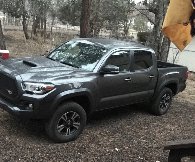

Got a 2017 I took all the chrome off and got matte black badges all around, personally I’m going to keep my trd sport sticker on.
OR17TRD i like the mud stickers you put on the lower part of the doors and rockers makes the truck look so sweet lol. ;) that's a good looking truck I like the way it sits .
