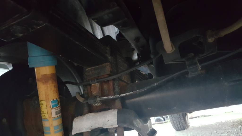

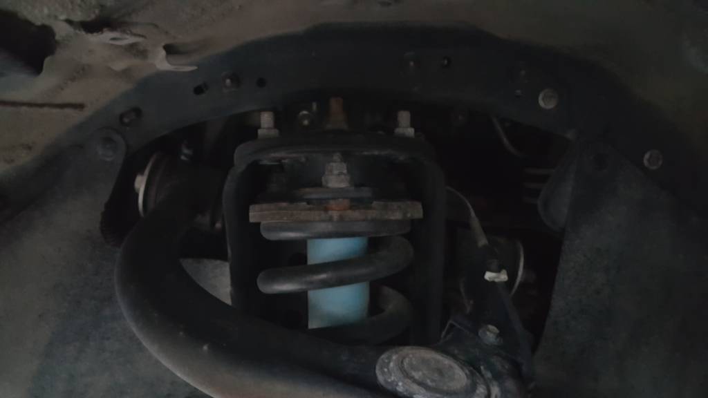

Alright guys.. Im looking to ditch this spacer and block but have a couple questions.. First.. how many inch is this front spacer? 2inch? 2.5? and can I achieve the same front lift with 5100's? Second.. Same question for rear.. This looks like a one inch block... So would a 1.5 AAL be good?? I would like to have a little factory rake back instead of a little bro lean which I have.. 20180418_195503.jpg20180418_195520.jpg20180320_173306.jpg
So u think my ****y front spacer is 2.5" ? I'm trying to keep the same lift height in front just in case i wanna run 285/70/17 again.
Put it on a flat surface unweighted and measure from center hub to bottom of fender. Subtract the stock height and you got your lift height. Center from hub to bottom of fender eliminates tire variable. Stock height on the second gen is about 20” in front and 21” in rear give or take 0.75”. Drivers side maybe lower due to taco lean.
