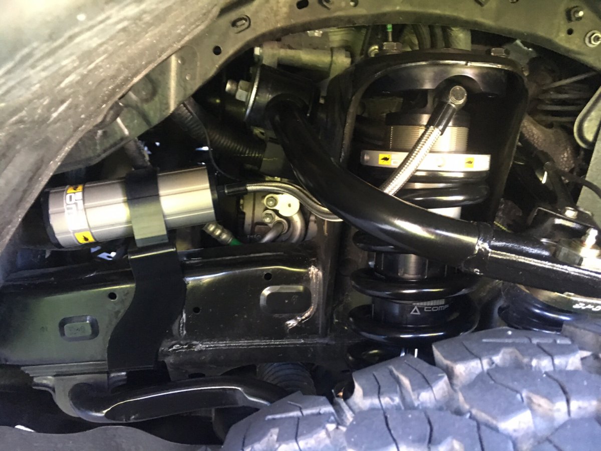

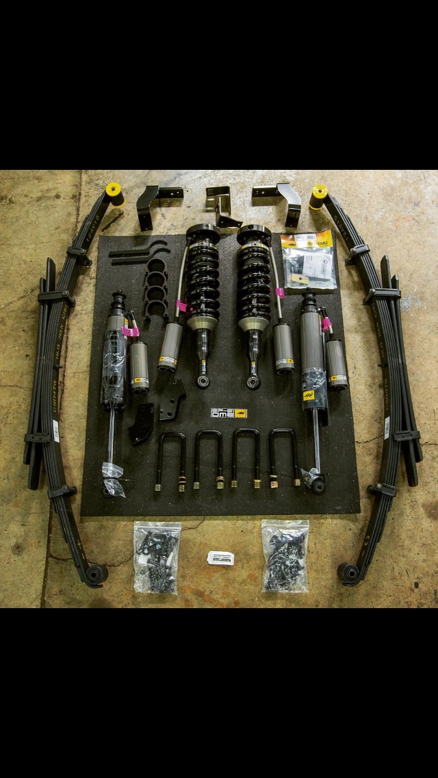

Look into Old Man Emu BP-51 kit. I have it on my 16 Taco Off Road and Love it! I’ve had Toyotas pick ups since 1988 . I’ve had many different setups and this one is my favorite. I’m using Light Racing’s Upper Control arms with a sealed ball joint with zerk grease fittings. IMG_1367.jpg
If your order is with OK Auto 4WD in NJ. They were giving Light Racing UCA’s at no charge with OME BP-51 kits. That’s what I have in my Taco.
The deal from Ok Auto is great! The added UCA's are SPC Racing, and I already ordered it. Thanks OU81taco16, its gonna be sweet.
