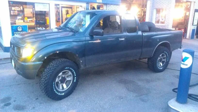

Got a 96 yota, wanna lift it. Thinkin add a leaf, block in rear and coil spacer?? Idk tho
Well if you're looking for about 2 inches of lift then get bilstein adjustable shocks up front and a add a leaf in the back
Well coil spacers arnt a very good choice, I would just save up and get the 5100s and sale current shocks you have now or something like that.
Well currently my truck is in the shop from an accident I got in and the shocks and what not are sitting in my living room waiting to be put on
The rear shocks don't lift. You need an AAL, block or new leaf pack to lift the rear. Also 5100s only work on 6 lug trucks.
I really wanna go like 4" but Idk if I'm gonna have to change, drop or do anything to my steering??...
