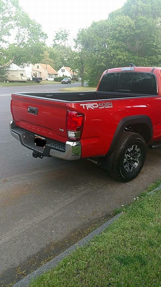

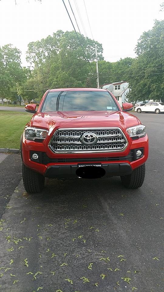

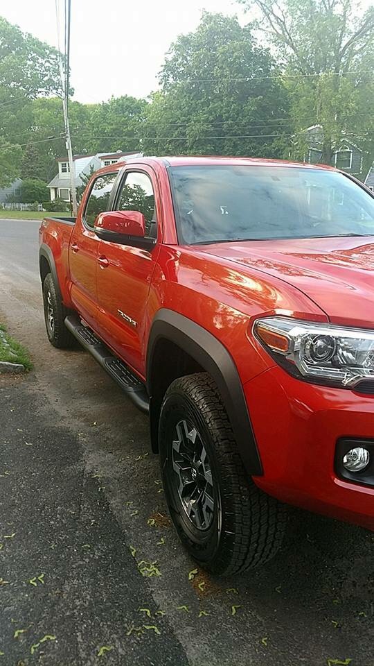

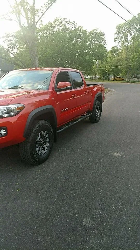

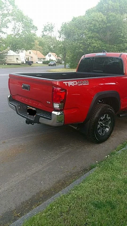

Thanks. I haven’t had the chance to do anything to it. In the near future I plan on doing a lot
It’s fun to mod them. Gets $$$. They have faux pro grilles for $150 that bolt right on. You can take the badges off easy enough or plasti dip them and the rear chrome on the bumper can be painted easy enough.
