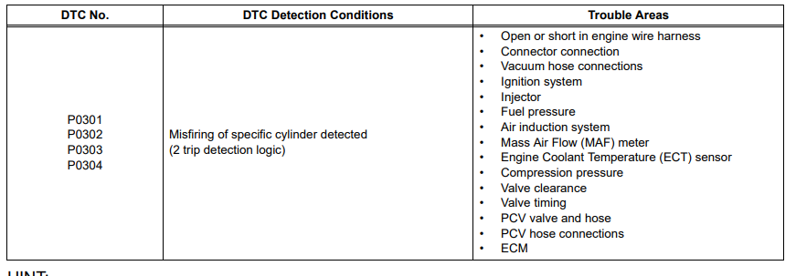

Give me a few minutes. Maybe I can find a clue in the '06 Repair Manual.
Ok, My manual does not cover 2007. So, take the following with a grain of salt.
This is from the DTC for the '06 4 cylinder engine.

refer to the potential "Trouble Areas" in the post at 9:19 am, today. Many potential electrical sources.

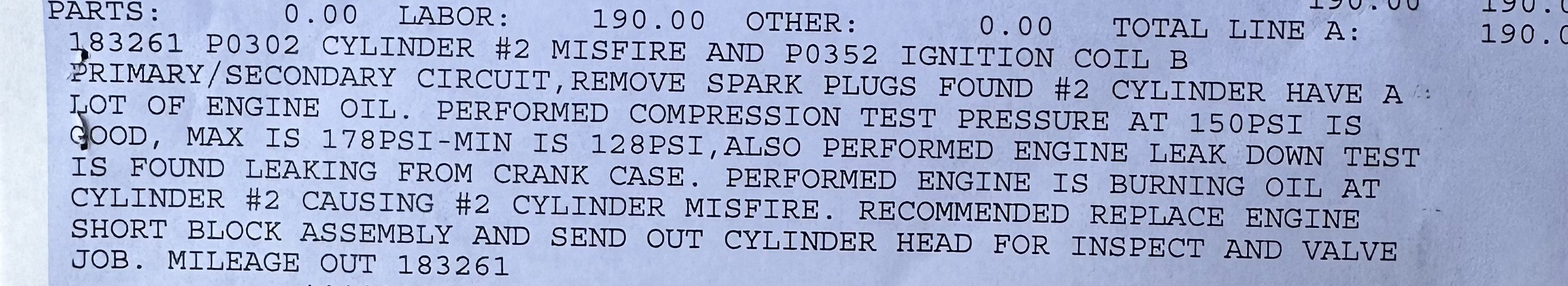

So I got the answer and they told me I have a leak on the crankshaft so it’s better off getting a new short block. Toyota quoted me $9200. I got the truck for $9000. I might get a second opinion. One place is telling me a leak on the crankshaft and another one an electrical problem.
Have them explain how a leak on the crankshaft will produce a misfire in cylinder #2.
Their solution does not make sense. No way should a leak of any kind need a new short block. Well, perhaps if the block is cracked.
Seems a bit wonky. Oil from the crankcase can only enter the cylinder by passing the oil control rings on the piston.
Compression test check the integrity of the valves and the compression rings on the piston.
The crankcase is not designed to hold pressure. That is one function of the PCV. As each piston moves up & down in the cylinder, it will pump air on both sides of the piston. Due to this motion the crankcase more or less breathes, commonly called windage
I'd pass on that shop to seek another diagnosis.
When you pulled plug #2, was it fouled with oil???
I don’t recall the spark plug being fouled with oil. Some of them did have some carbon build up, but I don’t recall spark plug on cylinder 2 having oil, perhaps alittle but oil, should have taken a picture.. I can take a picture of the current spark plug on cylinder 2 to see if it has oil. It should have oil if there is some sort of leak.

The way I see it, it's likely a head gasket. I guess it could be a cracked block, but not very common. The problem with these toyota iron blocks as they get old, they become real crusty, and in poor rebuildable condition requiring a new block. Maybe thats why they are recommending new.
