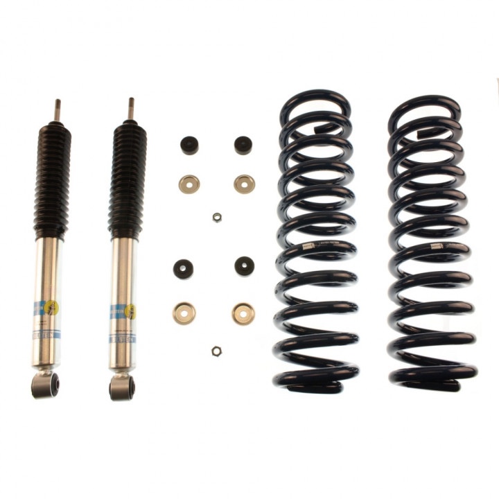

Thoughts on?
Lift with coils not shocks alone, preloading too much will lead to a rough ride.
Ur pic shows rear shocks and front coils...... What exactly are u thinking on buying?
U dont think u will be nose high?
Also at 2.5" ur looking at new upper control arms for factory alignment in most cases
Yes they did say I’d need to get new upper control arms. And 2.5” I don’t think would be nose high. What do you suggest if I’m just trying to level out the truck?
Find a flat parking space.
put a floor jack under the crossmember, DONT LIFT IT, measure the distance from the center of the wheel hub, to the bottom of the fender flare.
THEN lift the truck up with the jack until u think its level....
measure the same hub to bottom of fender flare.
the difference is your desired lift.
Not all trucks settle the same, some are used harder than others, not all even have the same leaf pack.... u may have 3 or 4 leaves.
again, LIFT WITH COILS
