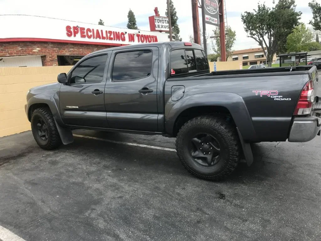

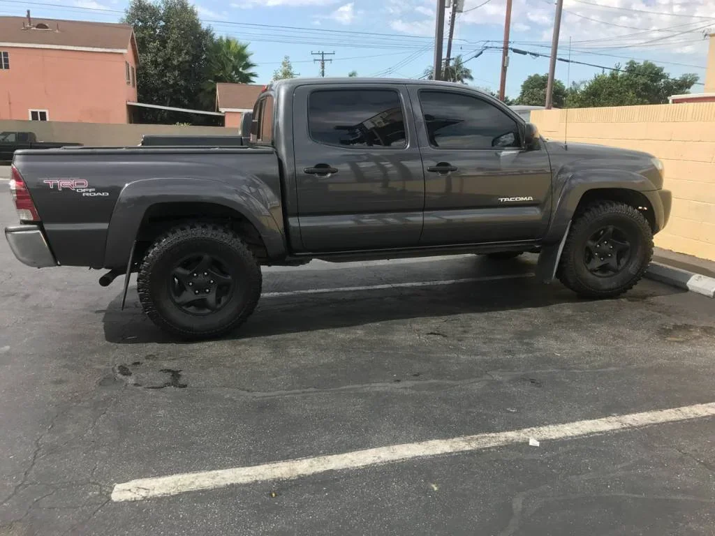

OR17TRD Well-Known Member Sep 12, 2017 #2 GUTIERREZ_DANIEL said: Tires rubbing when turning. Any suggestions View attachment 12580View attachment 12581 Click to expand... Take off the front mud flaps.
lovemytaco35 Well-Known Member Sep 14, 2017 #4 I had the same issue with rubbing. Removing mud flaps does the trick.
4wd Well-Known Member Sep 15, 2017 #7 aside from flaps you're probably rubbing before the flaps anyway, you'll need to trim some plastic & chop the cab mounts to eliminate rubbing (tire size obviously plays into this) Truck Looks good BTW..
