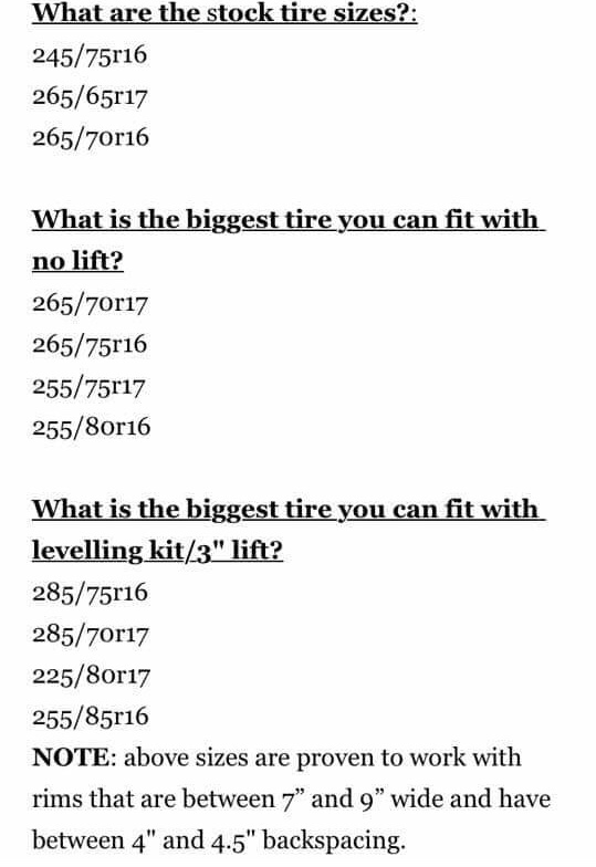

Hey, I just purchased the obligatory 3" rough country lift for my 18 tacoma. What's the biggest tire I can run without modifications. I've heard 285's, Is that correct?

Ok gotcha.. I thinks 285s are pretty much the limit but @OR17TRD is our lift/tire and wheel expert. Maybe he will chime in
265/75/16 or 265/70/17 on stock wheels.
285/75/16 or 285/70/17 with the right offset and or wheel spacers.
O or -6 offsets seems to work well.
Maybe a 305/65/17 on a +4 offset if you want fat
Or a
275/70/18 on +18 offset if you want taller skinny.
Any of those it’s about the right offset of the wheel and a good alignment to limit rubbing. You might have some rubbing at full lock. The wider or lower the offset you go the more likely it will rub.
