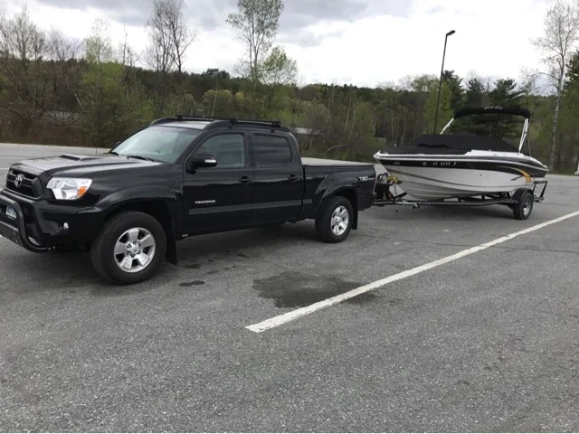

Just took a 5 hour trip towing a newly purchased 20 ft boat, weighing about 5200 lb including the trailer. On flat roads, the Tacoma didn't mind the load, but didn't seem to like the long uphill grades of Northern Vermont. Planning a 1000 mile trip with it this summer, but I'm torn between keeping the Tacoma or getting something with a V8.
