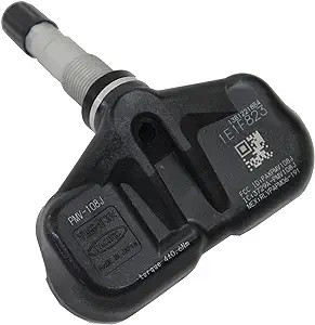

TPMS batteries are dead. Always change TPMS with new tires.

It is best practice to replace the TPMS when you replace the tires.
The truck was not made with Michelin Defender tires. Somewhere in the truck's life the worn tires were replaced with the Michelins. THAT was the time to replace the TPMS. I would guess you purchased the truck used and the previous owner installed the Michelins without replacing the TPMS sensors. The TPMS have a battery to run the electronics. The battery has a finite life. Once the battery is dead, the TPMS system will flash as a warning of a fault.
The dealer's only "FIX" is to crack open each tire to install a new TPMS in each tire. Don't forget to check the spare for a TPMS. BTW, you do not need to see a dealer for the fix. Any competent tire shop has the ability.

They sell aftermarket sensors at tire dealers, but many have claimed it's a crap shoot if compatible with the vehicle like the manufactures ones are. They're suppose to last 5-7 years, or so from what I've been told. I also heard the later toyota tpms ones are suppose be repairable with replacement battery sections, like on the gen3 tacomas.....idk, if so, or not. Older ones are not. You have to buy the complete sensor....not cheap.
