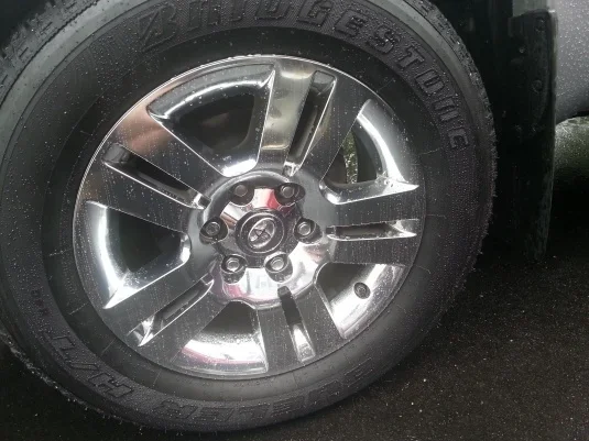

Thanks! But I don't think any of those are my wheels, it's not a prerunner and its 6 lug.Its a 2013 dclb tacoma limited 4x4 Here's a pic....

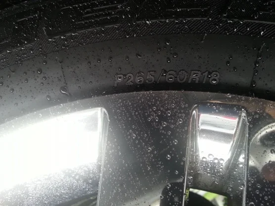

I just found in my owners manual that my rims are 18"x7 1/2 j.I don't know what the back spacing and offset is, and I know they are 6 lug but don't know if they are 6x5 or 6x5.5 or 6x4.5, how can I tell? Btw what does the "j" mean in the wheel size?
The back spacing may be stamped or imposed on the inside lip on the back of the wheel. I would pull one off and see. My civic Si stock alloys had the back spacing stamped on it.
Thanks, I'll look at my spare tire tomorrow to see if it says anything, it rained today so it's really wet out, sucks! I don't know why it's so hard to find, even when I google 2013 TAcoma limited wheels, I get nothing, wtf??!!!?

I would bet that your spare is a steel wheel. But if you are going to crawl under the truck then you might be able to see the #'s on the alloy wheels with a flashlight.
I found this set on eBay. In the description at the bottom where is says wheel size/specs it has a 25 after the measurements. I would assume that would be the back spacing.
Yes that looks like the specs for my wheels, but it still don't tell me the back spacing and offset of those wheels.When shopping for wheels, wouldn't I need to know that? I never thought it would be so frustratingly tiresome to find wheels in my exact size that would fit. Most rims I find say that they are 18"x8 stating the tire size for that rim to be 255 60 18.I need 18"x7.5, and tires that are 265 60 18.I really like the look of 5 spoke black and chrome or black & silver rims. Anyone know a good site to look or what brand? I really wanted the black and silver fj wheels, I don't think they make the size I need though. What if I got 17" rims and larger tires? I don't want to throw off my speedometer or recalibrate it, that's why I am looking for the same exact size I have.uuuhg so frustrating, sorry for the long post! I appreciate everyone's help!
Surprisingly it's not, it's identical to the other 4 wheels.I found that out the second day I owned it, my buddy is a huge Toyota fan, he examined every inch of the truck. He wanted to see all the things Toyota changed since he bought his 94 pickup new!(before it was called a Tacoma)lol!
