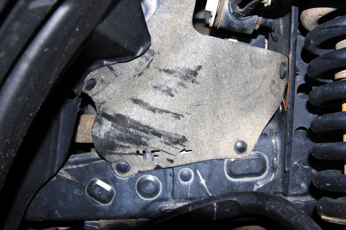

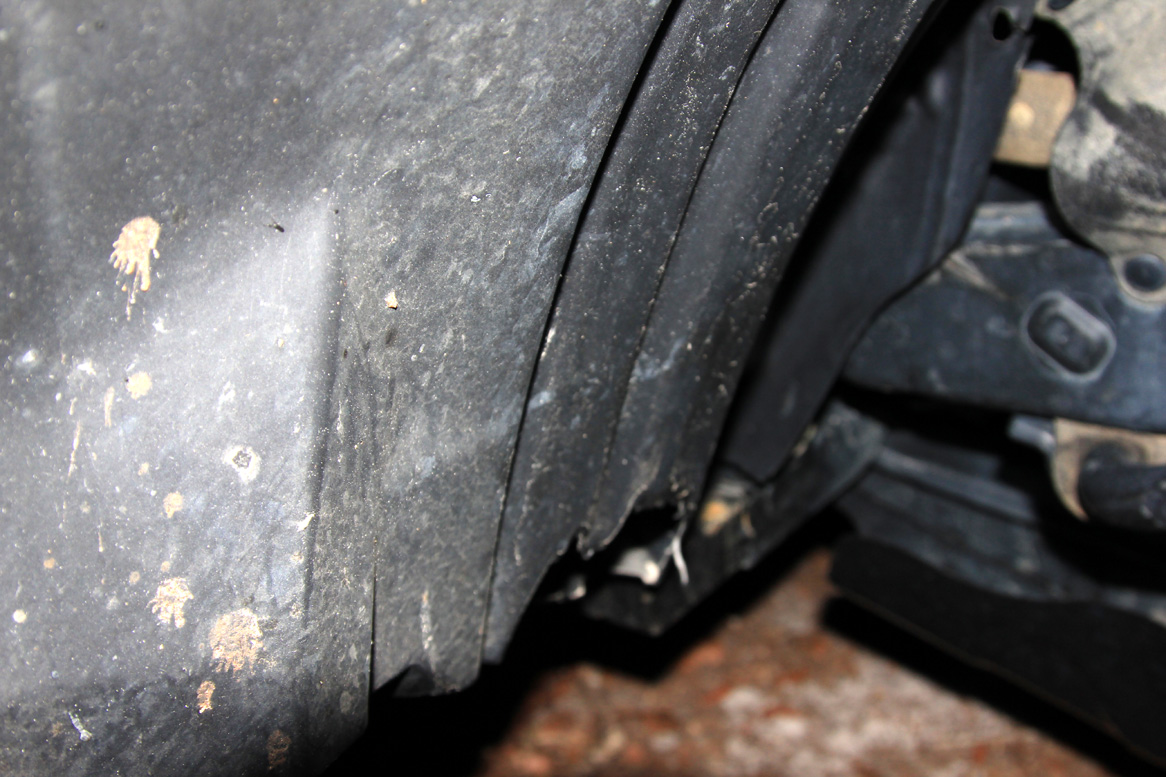

Here are some photos of my issue. First pic is of the trim and not the best pic but you can see where it has been damaged at the bottom from rubbing against the tire. I'll get some better pics when it's lighter outside. 2nd pic is of the flap that 2 of the rivets keep popping out and Toytota replaced, but still will not hold. There has never been any debris around this area and clearly no damage to it showing it is the rivets just not staying in place. You can also see where the trim has broken from where the rivet was holding it which is due to other rivets not holding in place and the wind pulling it back when I drive at higher speeds.

They're breaking your balls about that rubber splash shield? That's a new low. I thought you meant the wheel well trim.
I would write a letter to Toyota and include the pictures. Probably the holes in the frame for the push pins are too large.
It is the wheel trim and that shield. And get this. I paid for new rivets the 2nd time I brought it in which is supposed to be covered under a 12 month warranty since the dealership replaced them. They still won't cover it. I do agree though that maybe the holes are too large and that is possibly the defect which I'd like to find out.

I took those push pins out when I undercoated my frame when I first bought my truck. They were HARD to remove with the correct tool. Either undersized push pins or oversized holes is my guess

Yeah I agree they should be hard to remove to keep those parts in place. As of even now, the rivet on the bottom right of that splash guard can be pulled out with your hand as it is loose. I have shown that to the dealership, they replaced it, and it's still that way. But they say debris on the spare tire in the rear is the culprit.
