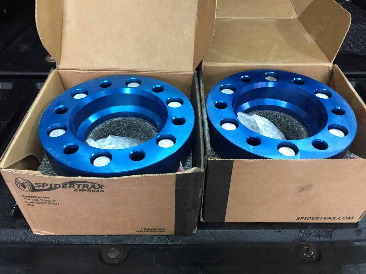

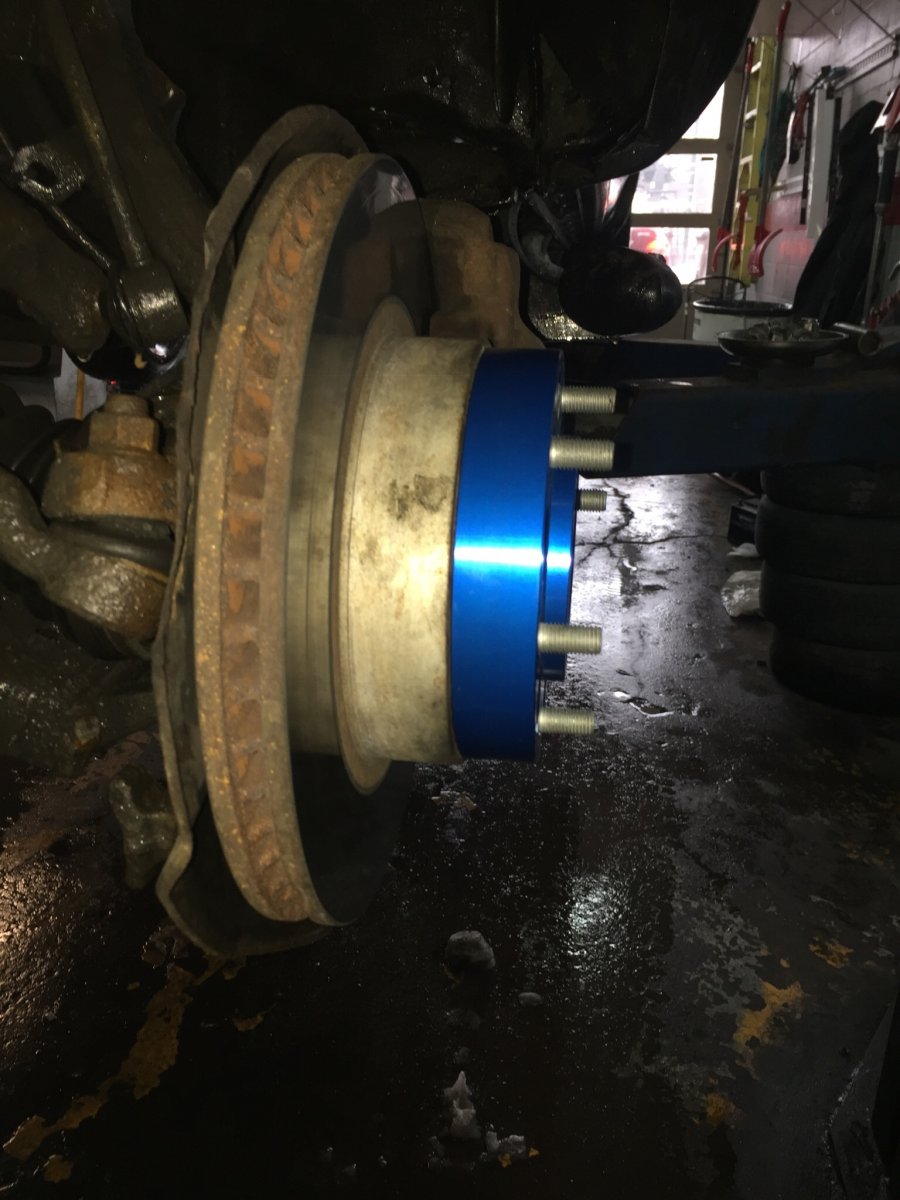

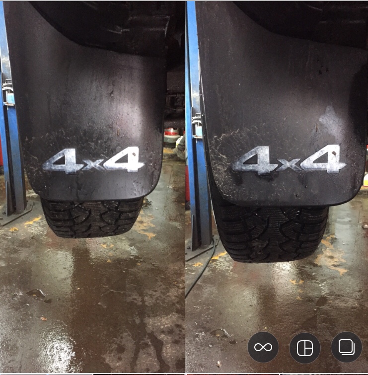

Hey..why because I Wanted to have a different look + wider stance like you mention. Please Explain your bad experience or issues.
People just like to be negative about things. I know people that have run wheel spacers for years with no issues. The stance looks good now. Be happy with what you’ve done and ignore negative comments.
By increasing the offset of the wheel, you place more stress on the axle’s studs, and in a front axle application on the unit bearings (or spindles) and ball joints of the axle. You also increase the tire scrub radius, changing the way the vehicle handles and increasing the difficulty of slow-speed turning. Also, by adding wheel spacers you are adding more components, and the more components, the more potential for failure. Make sure to properly tighten and torque all of the spacers’ bolts and nuts. Yes, it's the least expensive way to get the look you want. Kind of like using a leveling kit with spacers VS correct lift kit with coilovers. My son has had several lifted trucks with wheel spacers. Bearings were the first thing to go. But the trucks looked very cool. Just my opinion and not being negative as someone said who doesn't even no me.
