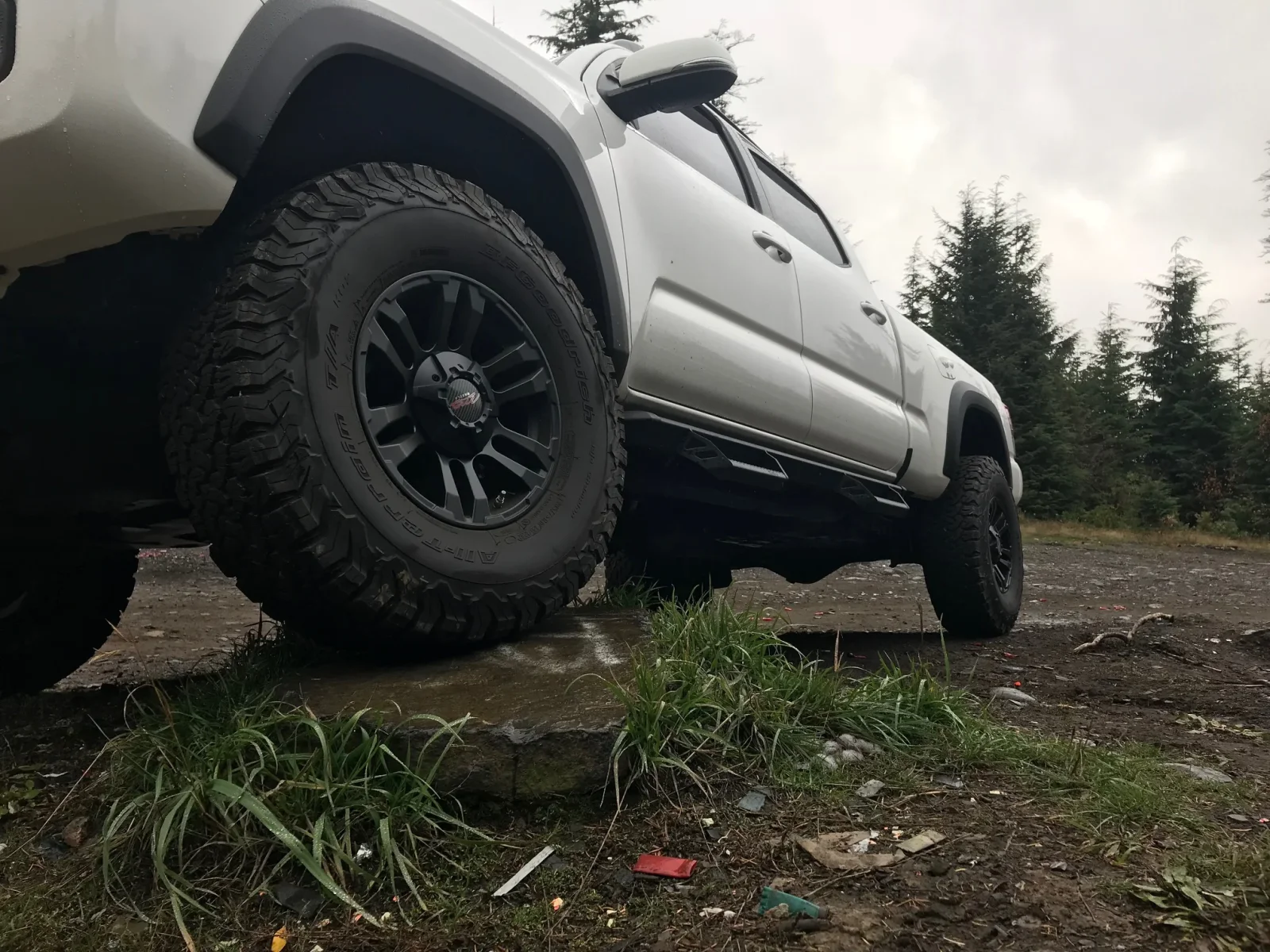

I’ve got 285/75/16 BFG KO2 on 16x8.5” MB TKO -6 offset. 89D266B1-56EE-4637-9314-8831E1CEF4AB.jpeg

I’ve got 285/75/16 BFG KO2 on 16x8.5” MB TKO -6 offset. View attachment 13880[/QUOTE
