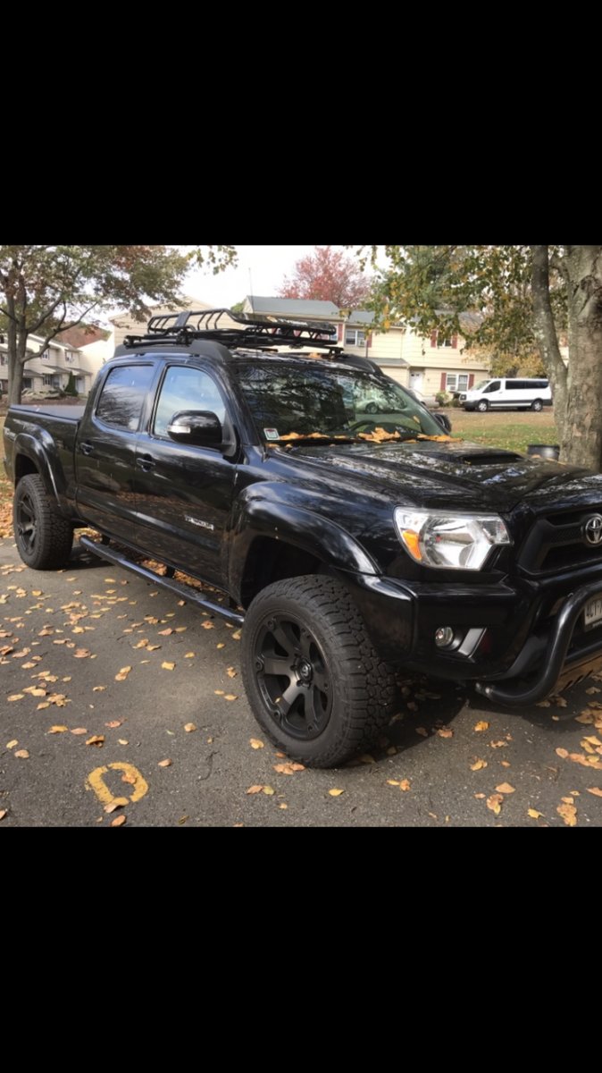

Looking to put some black wheels and all purpose tire's on my gen 3. I'm putting a 2in lift on next week.View attachment 17680

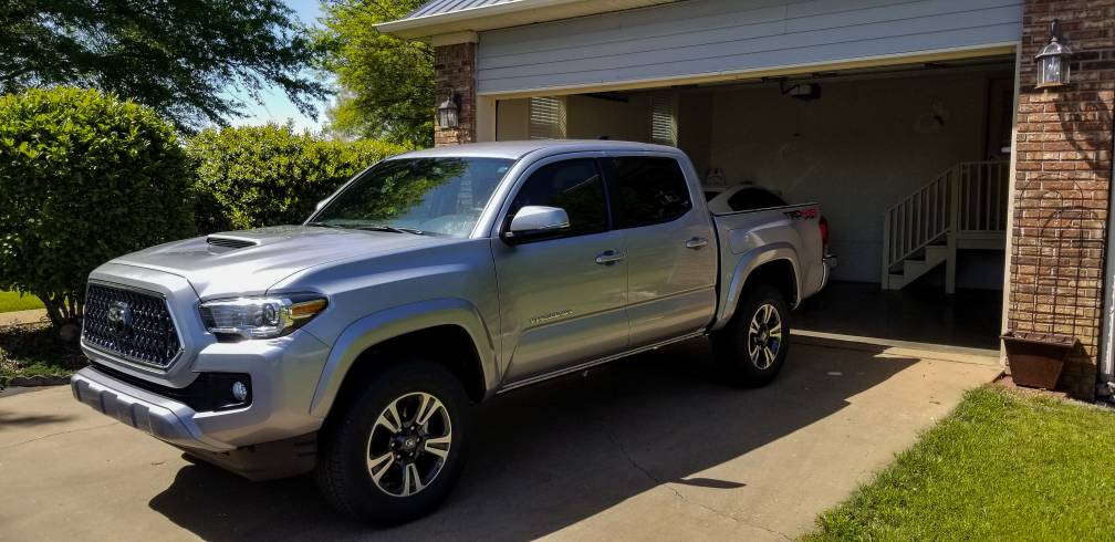

Factory wheels have a +30 on sports and a +25 on the off-roads they sit in from 0 which would be flush with the hub.This may be a dumb thing but, has anyone removed the fender flares to make the tires look a little more flush? Vs spacers or wider wheels. Factory wheels already have a decent offset
Which lift and offset? I really like this look. [emoji123]View attachment 18569
I’ve got a 3 in lift with black Fuel rims, Falcon tires.
