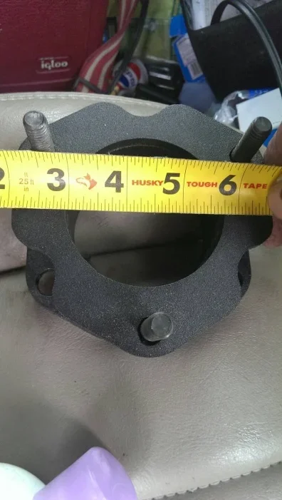

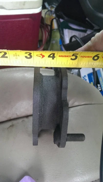

Hey thanks for the help guys! I will be getting a refund on all the chip stuff. Now, I do have another question. I recently got a 3" leveling kit for the front of my truck. I got it from "Hell Bent Steel". Now they only sent me these 2 spacers, and this kit is "supposed" to be adjustable. They sent me the nuts too, lol... Here's a pic. I'm gonna post the link to what exactly I got too.
http://m.hellbentsteel.com/2005-2010-toyota-tacoma-2wd-4wd-3-leveling-kit.html
Now their saying that to not be tricked just cuz these spacers are only 1.50" thick, that once installed, and with the strut extended all the way (i still don't know what this means) between the 1.50" spacers and the strut extended, that you will get you the 3", oh and after an wheel alignment. What do you guys think?

The actual dimensions of the spacer doesn't equal to how much lift you will get. I have never messed with that kit in particular or any spacer kit. Spacers aren't a good way of lifting.

You can lift with 5100s or even go full coilovers. It depends on your budget but 5100s are fairly inexpensive. That's Bilstein 5100s.
