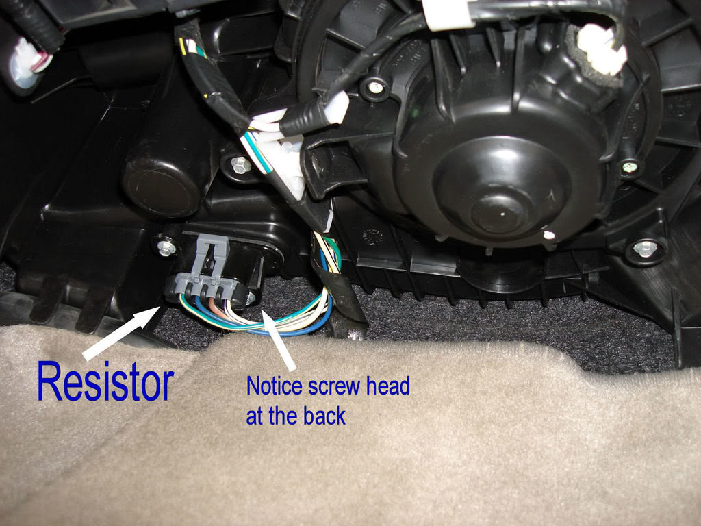

    Will only work on high. Any thoughts? How difficult to replace fan / where at?
  3. whippersnapper02
    Bad resistor. Check the wiring as well.
    OR17TRD and Bogunn like this.
  4. Scuzzy
    Scuzzy Well-Known Member
    Replacement fan is $62 and it takes 2 minutes to replace, or change the resistor for ??? (Maybe $0.50?) Passenger side, under dash, 1 wire plug and 3 bolts.

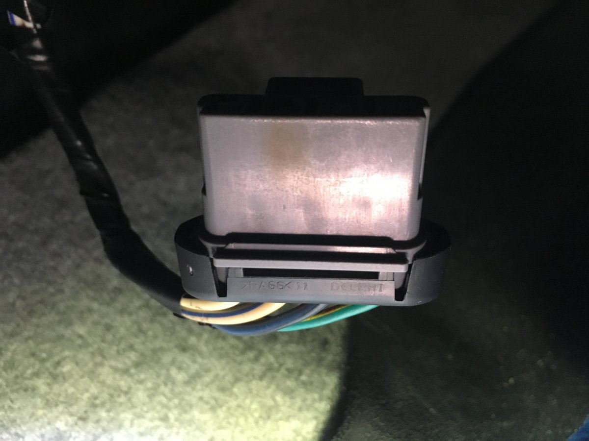

  6. whippersnapper02
    Super simple.

  8. whippersnapper02
    Under the passenger side dash.
    OR17TRD likes this.

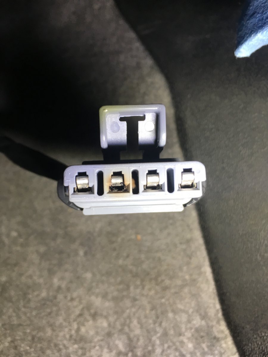

    Here's what my plug looked like:
    C4613C76-A857-4322-8B50-D625CDC71FE5.jpeg 5DD0D7E6-EA22-4328-A0AF-88065D22B663.jpeg
    My resistor may have been fine because I plugged in a new one and it still didn't work. I replaced the resistor and wiring pigtail.
