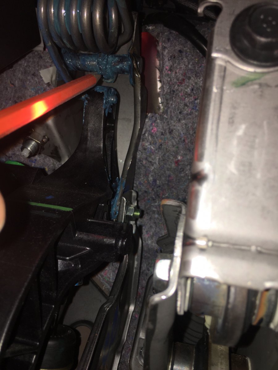

2016 clutch pedal squeak
It began a few months after purchase. I just did the second grease job in it( once a year) not bad. It’s where the spring goes into the plastic pedal. I used high temp bearing grease. View attachment 20239
