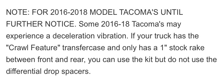

You shouldn’t have any problems with rough country as long as you are not extreme off roading or hauling butt like a raptor. I’ve had them in a super duty and a half ton silverado. Ride is similar to stock with no problems. Good thing about that kit is it has differential drop brackets and lifted knuckles so you don’t need an aftermarket UCA. Your CV joints stay straight with the diff drop too

How many diff drops have you used on Tacoma’s?
Diff drops are basically shims which in the end do nothing.
Drop bracket lifts like Junk Country use a drop bracket that is welded in place of the factory front crossmember. It works but you reduce ground clearance and they have been known to bend while doing moderate wheeling. Cutting of the crossmember is an automatic no no in my book.
Zero diff drops on a tacoma
I installed a 3” Revtek Pro 40013 lift on my 2017 Tacoma and the drop diff caused drive line vibrations, took it off those vibrations where gone. I was left with the needle bearing humming down the road at 35mph. ECGS bushing will fix the needle bearing if you get the vibrations from that.
If you’re going to use a spacer lift get one that uses in-coil spacers vs above coil and an AAL vs a block.
You don’t need the drop diff on a Tacoma.
Hhmm. Maybe revtek didn’t keep the same geometry? Or Maybe 3” isn’t enough to need a diff drop.
