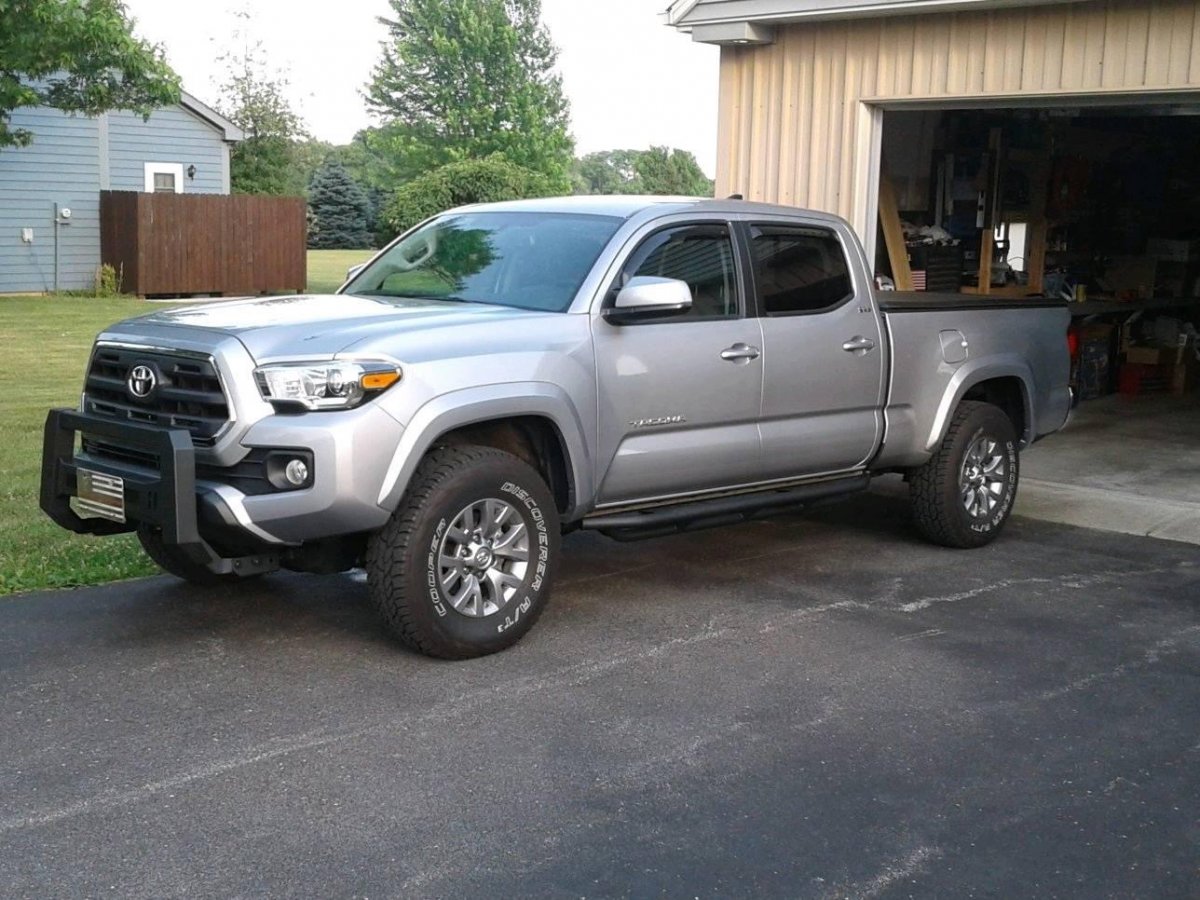

265/75/16 ,I did install 2" leveling spacers in front..$65 Rough Country alum..from 4WheelParts.com..about 30 min each side to install.very simple 20200704_091154.jpeg20200720_085902.jpeg

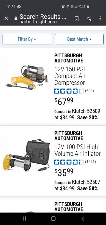

I went with this size so I have enough sidewall to air down for the beach as its a 2WD and git the $65 portable 12v compresor ar Harbor Freight. Comes with a slick carry bag and 16' hose.they both come with the bag shown.I got the top oneScreenshot_20200725-225104_Chrome.jpeg

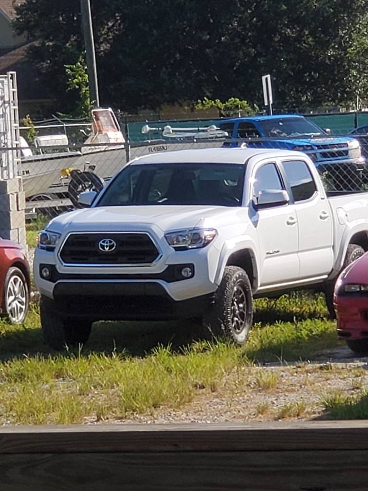

No lift required.

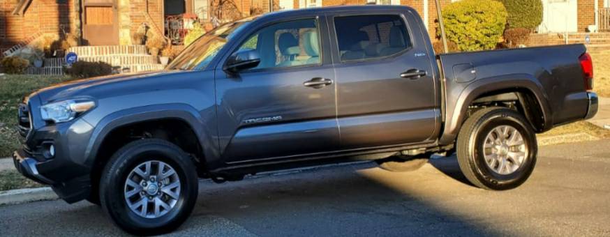

17” Wheels = 265/70 R17
16” Wheels = 265/75 R16
Best looking tires (IMO)

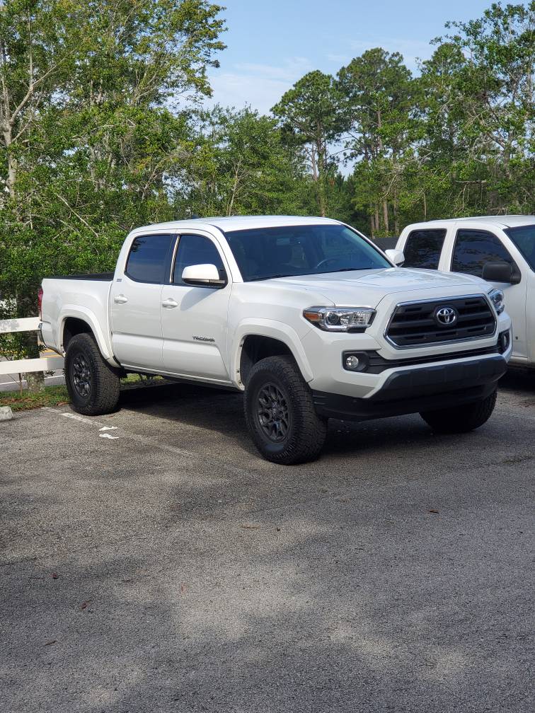

Nitto Ridge Grapplers
BFG K02
If your not doing a lot of off-road, I would recommend trying to find a C load range tire in the sizes listed above.
I have the 4 ply Nitto Ridge Grapplers on 17s and I love them.
