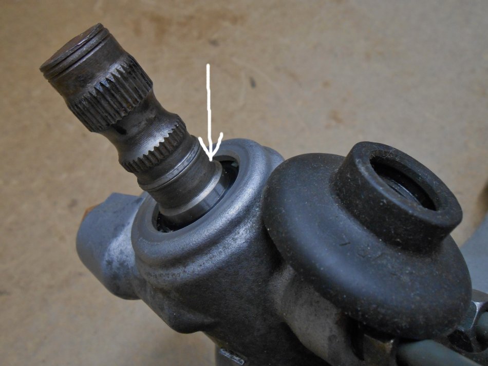

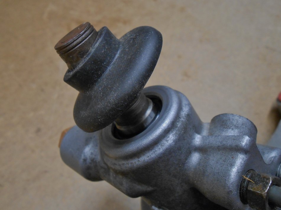

Thats where mine was leaking also. I had to change the rack when the steel body itself finally had two holes rust through it. I was using Lucas steering rack stop leak for it for a few months, till it totally went. When I changed the new rack, it was all aluminum, no more steel body.

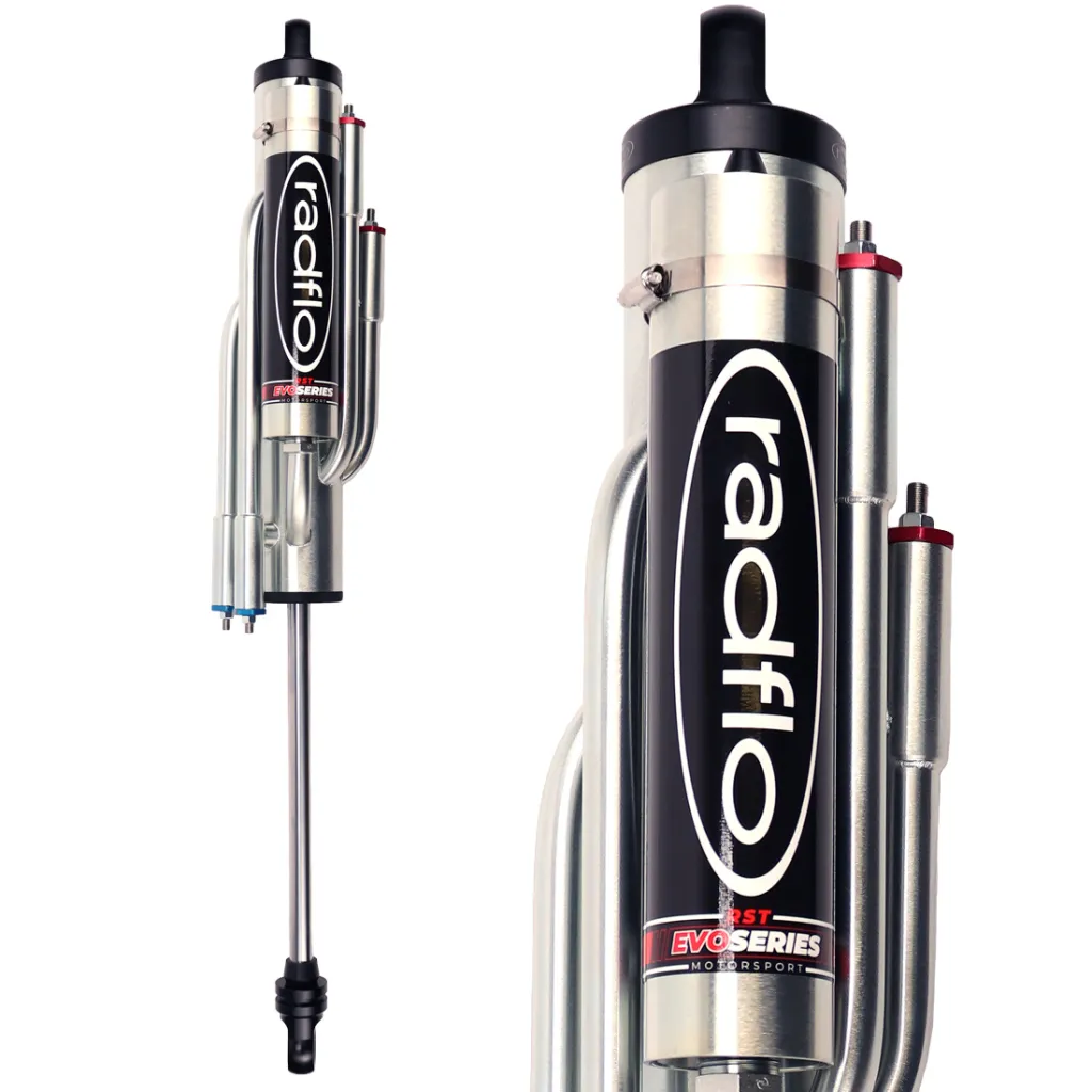

Those rebuildable gas shocks are big dinero's

I have said before. Your suspension troubles are likely deeper than just a simple set of shocks. No matter how good they claim to be or how high the cost.
Shocks are only 1 piece of a system. Their purpose is to dampen the spring rebound. Springs support the weight. Bushings allow movement and isolate vibrations. Torsion bars control body lean in corners. Each part has a purpose. If a part is failing or has failed, then the whole system is compromised. Then you have the complexity of the steering with UBJ, LBJ, tie rods, steering system....... Lets not forget the bushings that support the cab. All these parts wear and age.
Consider, the truck is over 300 Kmiles. Have you done anything to the suspension besides throw shocks at it during these 300???
Its probably time to park the truck and begin solving issues and replacing worn parts.
