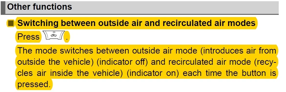

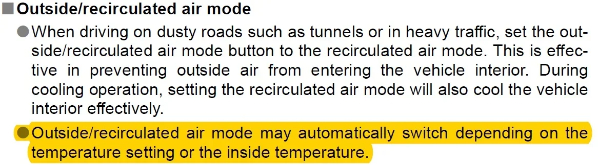

What's up guys. First time truck owner here 17' trd off-road double cab. Only issue I seem to be having is when I turn off the a/c or heater I still get some air coming through the vents. Air comes out in any mode wether it's in defrost/front vents/floor. Not sure if it's an actual issue or not. Any of you guys experiencing this?
The previous gen truck would automatically open the fresh air duct to keep the cabin heating up. You had to push and hold the button for 5 seconds when closing to disable the auto open function. I’m not sure if the new trucks have this. Also you cannot recirculate when you have the vents set to defrost.
They are the auto climate controls it’s all electric. I work at a dealer where I’ve seen similar issues but there are no fixes for because it is “normal”

Most vehicles always have airflow through the vents. But not on recirculate. I haven’t noticed it on my 17. I’ll have to pay attention to see if it’s an issue.
