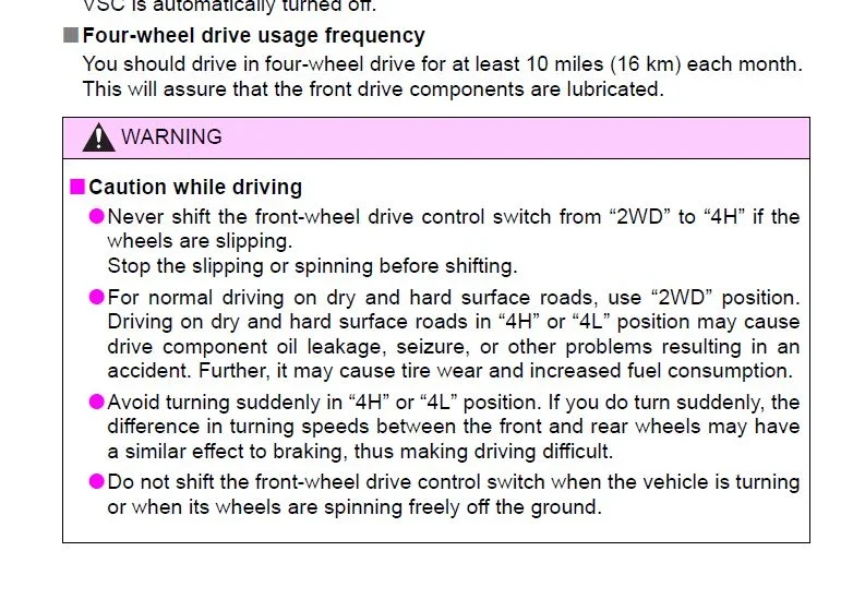

I just picked up a 2017 Sport. 50 mikes on it now. I do feel some shuddering when backing out of my garage and maneuvering in my driveway. It feels like the it slips or engages/disengages. It feels a lot like that computer controlled clutchless transmission in Volkswagens or a Porsche PDK transmission.
Not sure if it is normal or not. But I think not. There should be no reason for that when backing straight out of a garage.
I will drive it a few more days and if it keeps happening, I will take it to the dealer to check the fluid level.
I noticed resistance when backing out of my driveway this morning in 4x4. It's slightly downhill so it was odd. Haven't experience it when backing out in 4x2. Will have to see if it happens again.

Edit: Went back out and experienced shuddering in 4 high in reverse and coming to stop in drive. Called dealer and heading in now.

So I just got back from the dealer. They have a service lane to pull into and as soon as I pulled in and explained my concern they got the service manager. He came out and asked me my concerns. I told him how it felt like brakes were being applied when I reversed in 4H and how I felt a judder when turned to almost full lock etc. He right away told me that it is normal operation and estimated it would happen as soon as we turned out of the service lane, sure as **** it did it. It hapened exactly when he expected it to, same as when I came to expect it to. In 2WD no issues occurred. He opened up the owners manual and found a passage that described my experience almost to a t. When we arrived back to the lot he grabbed the keys to another spankin' new Taco (TRD double cab versus my SR5 double cab).
It did the same thing, exactly when expected.
Soooooo....while I think it's funky, the explanation in the book makes sense and another truck on the lot did the same thing.

See attached screen cap from the owners manual.

Turning in 4wd causes driveline bind. All vehicles with part time 4wd do it because there is no center diff like in full time 4wd/awd vehicles.
Thank you.
I find myself thoroughly uneducated on this and I just looked up more info on driveline bind based on your reply. Makes total sense now.
