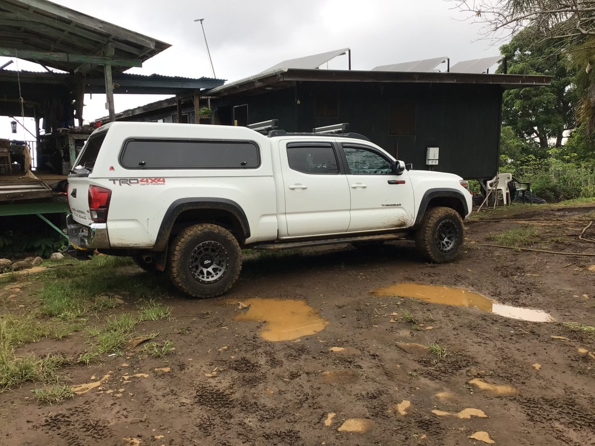

I suggest the ARB air breather, I located mines in the driver side taillight housing. High flow, zero back pressure, zero vacuum ,filter. Worth the price. This is a one time purchase, get the best.
Why? My stock air breather fail, I live on a dirt coffee farm, when it rains the roads has muddy puddles, something got struck in my breather, keeping it open. Cost me over $3,500.00 to to replace the the third member, all new! 2019 TRD OR LBC32718C5-2E43-440E-BA38-929249F831B0.jpeg
