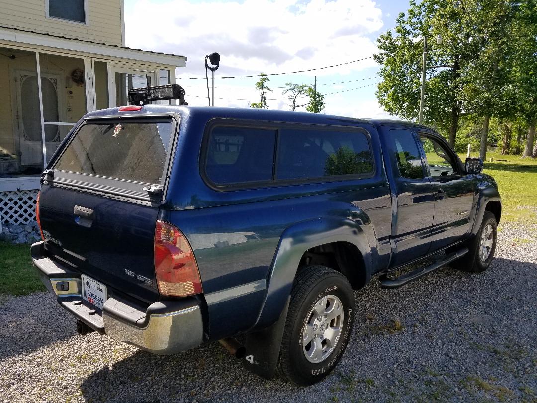

Went with 265 75R 16 so glad I didn't go any bigger. Will check the pirate4x4 out. Did order some two inch spacers for the front, ordered the back in a 3 inch lift going to have some stuff in the ass end of the bed so 3 should squat down to 2 by the time its all over. Thats the truck. Going to have to repaint it going to go a little lighter blue but enjoying fixing it up so far.
