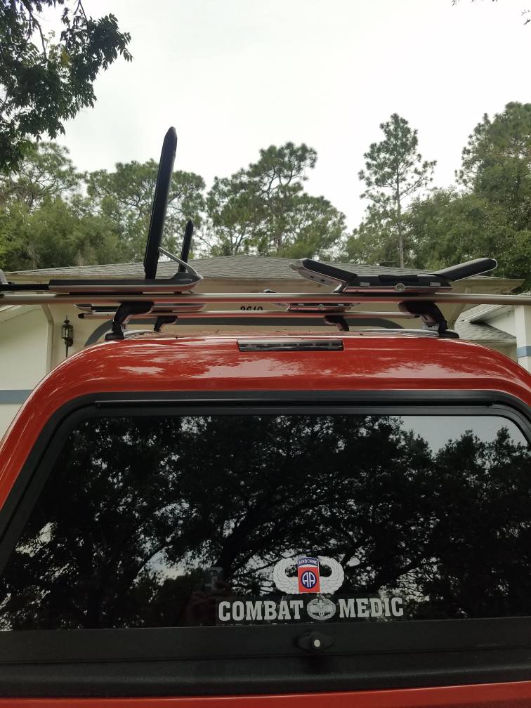

    Our yaks are 12 and 13 feet. Now that the topper is on, Im using Yakima. But before, I used an extender. T-bone Boondox. 20180812_182151.jpeg

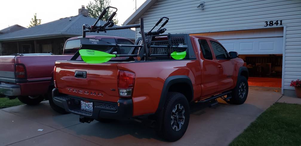

    Made my own and kayak paddle attachment. My kayak is 12ft long. 20180518_203747.jpeg

    Well I didn't completely make it, just bought a cheap ladder rack and cut about 8inches of height and made a bracket for my headache rack. Cost a whole whopping 80$ for the ladder rack set and 100$ for the kayak attachments. Saved about 400$ instead of buying a thule.

    Ain't nothing line some good old back-yard engineering. Nice work.

    Is that the 60 dollar rack on amazon? I was wondering how easily it could be cut down for reduction in height.

    Yep, you can only cut down a couple inches before the bend, there is a plug that goes inside the tubes that connect the tubes together. You have to cut them out so you can reuse them.(there only spot welded in). It only took about an hour to re-fab. Pretty easy.
